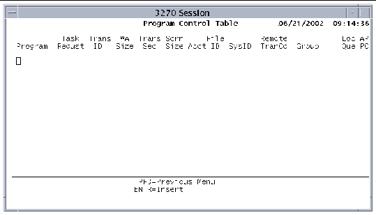

1. Type CTBL on a blank transaction screen to open the Table Manager.
2. Press PF4 - Standard Tables, then PF6 - Program Control Table.
3. Press PF4 to display the insert screen.
4. Enter the following information to define the remote transaction:
a. In the Trans ID field, type the name of the transaction on the local system.
b. In the SysID field, type the local identifier of the remote system.
This SysID must be defined in the TCT-System Entries table.
c. In the Remote TranCd field, type the name of the transaction on the remote system.
5. Press Enter to insert the data and return to the PCT screen.

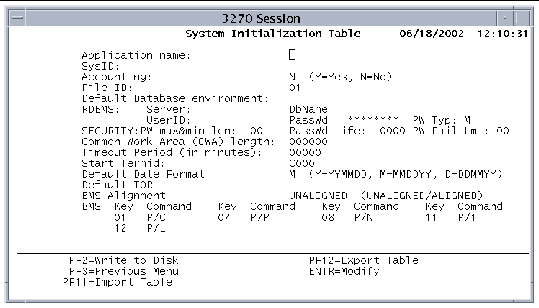

1. Press PF1 on the Table Manager - Standard Tables menu to open the SIT.
2. On the SIT screen, specify a Start Termid with a name that is different from any Term ID on the remote systems.
The Start Termid is the name of the first default Term ID. A value of 1 is added to all subsequent terminal names to make them unique.
3. Press PF2 to save the table when you are done.

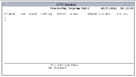

2. Press PF4 to display the insert screen.
3. Define the remote program using these fields:
a. In the Program field, type the name of the program on the local system.
The SysID must be defined in the TCT-System Entries table.
c. In the RmtProg field, type the name of the program on the remote system.
d. In the RmtTrn field, type the name of the transaction that the program runs under on the remote system.
If blank, the program runs under the standard mirror transaction. You can use this field for accounting or security.
4. Press Enter to add the entry to the table.
5. On the main PPT screen, press PF2 to save the table.
