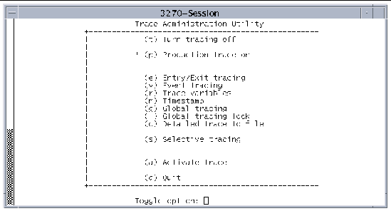

Use the kixetrace utility to display the Trace Administration Utility menu.
[ D ]
An asterisk (*) is displayed next to any option that is selected.
When the trace facility is first run, the menu always shows Production trace on as selected. This does not mean that production trace is turned on; it is the default. The menu does not indicate the options with which Sun MTP is running.
