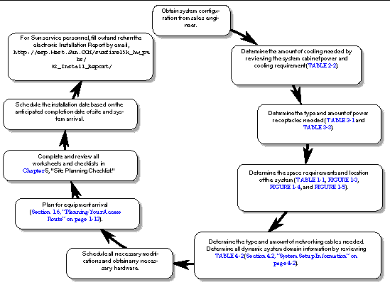

Sun Fire 15K/12K systems come with various environmental requirements. Review the site preparation process flow diagram shown in FIGURE 1-1 as you begin to evaluate the needed requirements before your system installation.

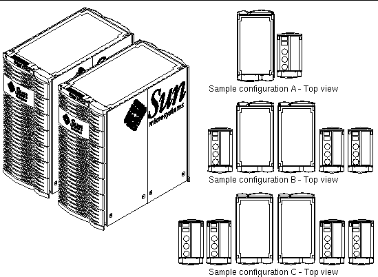

Multiple cabinet configurations (FIGURE 1-2) would include additional customer selected I/O expansion racks with I/O cabling (customer-specified length). Customer selected I/O expansion racks house additional I/O disk or tape subsystems. Additionally, each I/O expansion rack contains AC distribution subsystems for use with the I/O subsystems.
Multiple cabinets may be placed side-by-side as long as the environmental specifications in Chapter 2 are met.
When determining the space, cooling, and power requirements, determine what system and I/O components will be used in your system. To begin the process of preparing your site for your Sun Fire 15K/12K systems, record your configuration on the worksheet in TABLE 2-3.

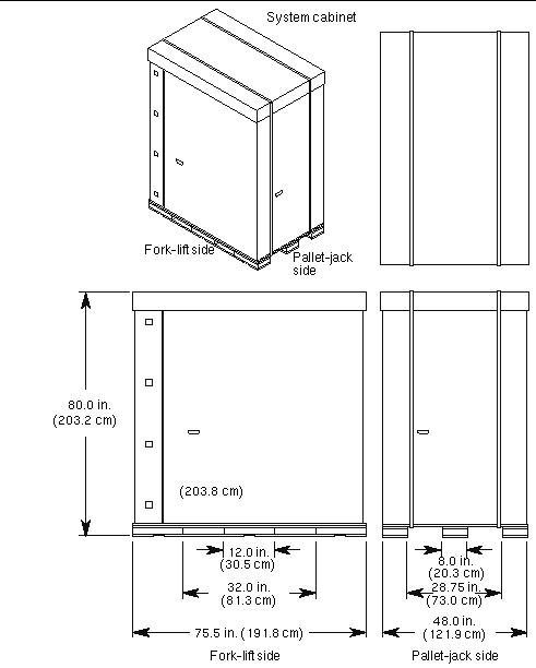

FIGURE 1-3 shows the dimensions of the Sun Fire 15K/12K systems cabinet crate.

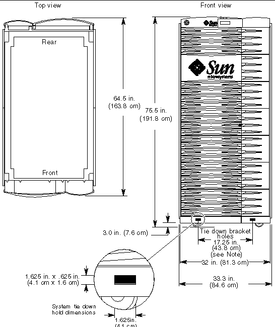

FIGURE 1-4 shows the dimensions of the Sun Fire 15K/12K systems cabinet.
Note - There might be slight variances in some component weights depending on customer configurations. |

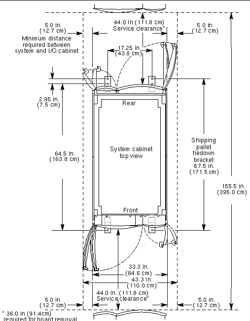

FIGURE 1-5 shows the clearance dimensions of the Sun Fire 15K/12K systems cabinet.

The cabinet has a concentrated load weight of 628.0 lb (285.5 kg) per three-inch caster (within the allowable load for a typical computer room raised floor). Review your facility floor weight requirements prior to moving the Sun Fire 15K/12K system to its new location.

Note - The Sun Fire 15K/12K systems require a shared-aisle space of 4.0 ft (121.9 cm). For the foot print weight, only unit dimensions and weight are calculated. For system-shared aisles of 4.0 ft (121.9 cm) (see FIGURE 2-3), assume two 48.0 in. (121.9 cm) tiles are at the of front and rear of the system with a weight allocation of 50% for each system. |

If your existing loading dock meets height or ramp requirements for a standard freight carrier truck, you can use a standard 60-inch pallet jack (at narrow end of pallet) to unload the system. Trucks can be between 48 ft (14.6 meters) and 61 ft (18.6 meters) long, 8.5 ft (2.6 meters) wide, and 14 ft (4.3 meters) high. If your loading dock does not meet these requirements, use a standard forklift (at wide side of pallet) or other means to unload the system, or request the system to be shipped in a truck with a lift gate. A standard forklift has a maximum outside tine dimension of 27 in. (68.6 cm) and a minimum inside tine dimension of 15 in. (38.1 cm).
An illustration of the system cabinet shipping crate and its dimensions are shown in FIGURE 1-3. A pallet jack is required to move each shipping crate to the system location.
Sun Microsystems recommends that you leave each system cabinet in its shipping crate until it reaches its unpacking destination. If the system does not fit through the planned access route, it can be partially disassembled after the unit has been removed from the crate. To accommodate the tight space availability, the side panels can be removed. This reduces the width of the system cabinet to 32.0 in. (81.3 cm) from its original width of 33.3 in. (84.6 cm).
