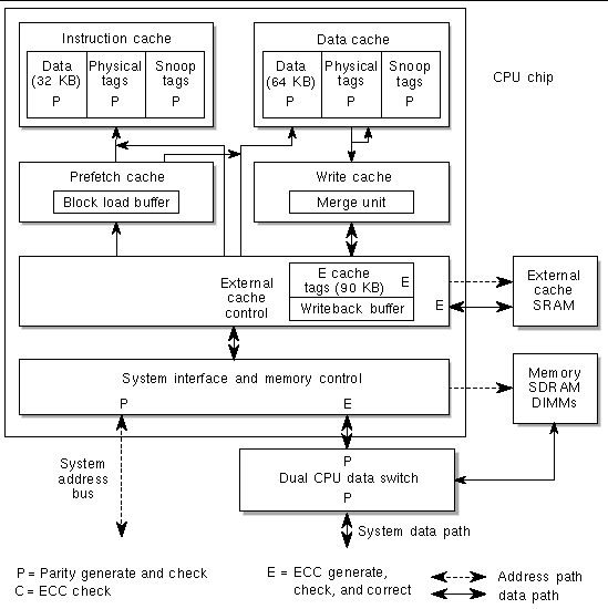

The CPU has error correction code (ECC) protection on its external cache SRAM and parity protection on the major internal SRAM structures, as shown in FIGURE 3-1. The letters P and E in the block diagram denote parity generate and check; and ECC generate, check, and correct by the receiving unit, respectively. A parity error on an internal cache structure is corrected by software, ensuring correct operation after the fault.
The external cache data resides on eight high-speed (4 ns) SRAMs. A single-bit error-correcting and double-bit error detecting code protects the 64-byte-wide cache lines. Errors during data-cache or instruction-cache fills are recovered by software flushing and invalidation. Errors during system data transactions are corrected by hardware.
The Sun Fire E25K/E20K address bus connections between the CPU and the address repeater are protected by parity.
The CPU generates both parity and ECC for all outgoing data blocks. The parity is checked by the receiving dual-CPU data switch. The ECC is checked by all data switch units in the path of a transfer. ECC is checked and corrected by the CPU when it receives a data block.

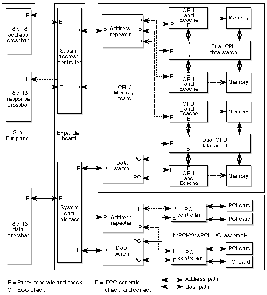

FIGURE 3-2 shows the protection methods at various points in the address and data interconnect. The letters P, E, and C in the block diagram denote parity generate and check; ECC check; and ECC generate, check, and correct by the receiving unit, respectively. Dashed lines denote the address interconnect, and solid lines denote the data interconnect.
The Sun Fireplane interconnect address bus has three parity-error bits. In addition to the bus-level protection, the address and response crossbars on the Sun Fire E25K/E20K Sun Fireplane interconnect have ECC protection for address transactions across the Sun Fireplane interconnect. The ECC corrects single-bit address errors and detects double-bit errors. An address parity or uncorrectable ECC error stops execution in the affected dynamic system domain.
All data interconnect transactions move a 64-byte-wide data block. System devices generate ECC when they source data, either for a write from the device or in response to a read of the device. They check ECC and correct single-bit errors when they receive data. Data is thus protected against both memory and data path errors from end to end.
If system devices checked only ECC when they received data, it would be difficult to diagnose the cause of an error. If a device generates bad ECC on a write to memory, the error can be detected by some other devices, but the cause of the error is difficult to isolate. There are two additional checks to help isolate the cause of the errors:
The ECC checks that are performed by the data switch can identify the source of ECC errors in most cases. A particularly hard case for ECC error correction occurs when a device writes bad ECC into memory. These errors are detected much later by other devices reading these locations. Since the bad device writer might have written bad ECC to many locations and these might be read by many devices, the errors appear to be in many memory locations while the real error might be a single bad device writer.
Because the data switch ASICs check the ECC for all data entering or leaving each device from other devices, the original source of errors can be isolated. For example, a bad device writer that writes bad ECC to a memory on a different board produces ECC errors that are detected in two data switches. The direction and transaction tag information can identify which CPU pair was the source of the error and which device is the target of a bad ECC device writer.
If the bad device writer writes bad ECC to its local memory, the data does not pass through a data switch. Therefore, the bad device writer is not detected until the data with the bad ECC is read by either the same CPU or another device. In either case, the cause of the ECC error can be isolated to the pair of CPUs that share the dual CPU data switch (DCDS). If the data is read by the same CPU, the fact that the data switch on that board never detected an error indicates that the data was corrupted by the local CPU or the DCDS. If the data is read by a different CPU pair, then the data passes through a data switch and the ECC error is detected as originating from a particular DCDS or the associated CPUs.
