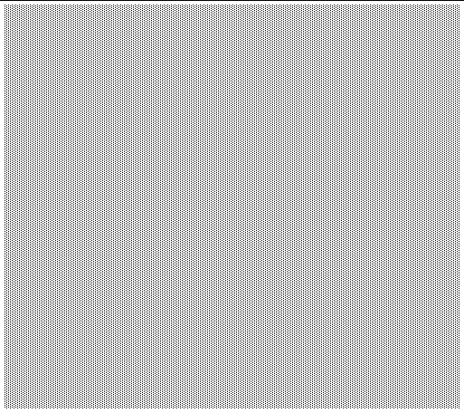

The Management Network (MAN) function maintains the private point-to-point network connections between the SC and each domain. No packets addressed to one domain can be routed along the network connection between the SC and another domain (FIGURE 9-1).
Figure depicting an overview of the Management Network.

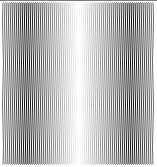

The hardware built into the Sun Fire high-end system chassis to support MAN is complex. It includes 18 network interface cards (NICs) on each SC that are connected in a point-to-point fashion to NICs located on each of the 18 expander I/O slots on the Sun Fire 15K/E25K system and on each of the 9 expander I/O slots on the Sun Fire 12K/E20K system. Using this design, the number of point-to-point Ethernet links between an SC and a given DSD varies based on the number of I/O boards configured in that DSD. Each NIC from the SC connects to a hub and NIC on the I/O board. The NIC is an internal part of the I/O board and not a separate adapter card. Likewise, the Ethernet hub is on the I/O board. The hub is intelligent and can collect statistics. All of these point-to-point links are collectively called the I1 network. Since there can be multiple I/O boards in a given domain, multiple redundant network connections from the SC to a domain are possible.
Figure depicting an overview of the I1 network for the Sun Fire 15K/E25K.
Note - The I1 MAN network is a private network, not a general-purpose network. No external IP traffic should be routed across it. Access to MAN is restricted to the system controller and the domains. |
On the SC, MAN software creates a meta-interface for the I1 network, presenting to the Solaris OS a single network interface, scman0. For more information, refer to the Solaris scman(1M) man page.
MAN software detects communication errors and automatically initiates a path switch, provided an alternate path is available. MAN software also enforces domain isolation of network traffic on the I1 network. Similar software operates on the domain side.

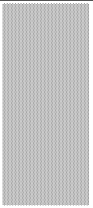

There is also an internal network between the two system controllers consisting of two NICs per system controller. This network is called the I2 network. It is a private SC-to-SC network and is entirely separate from the I1 network.
MAN software creates a meta-interface for the I2 network as well. This interface is presented to the Solaris software as scman1. As with the I1 network, I2 has a mechanism for detecting path failure and switching paths, providing an alternative is available.
Figure depicting an overview of the I2 network.

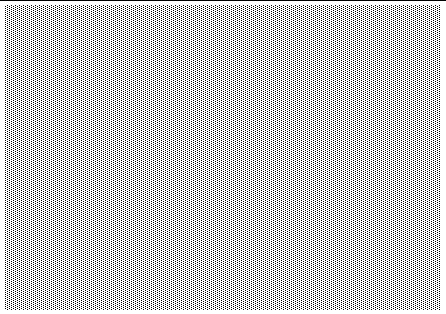

External Network Monitoring for the Sun Fire high-end system provides highly available network connections from the SCs to customer networks called communities. This feature is built on top of the IP Network Multipathing (IPMP) framework provided in Solaris 9. For more information on IPMP, refer to the System Administration Guide: IP Services.
External networks can consist of communities. You can have zero, one, or two communities. Zero communities means external networks are not monitored. During installation, user communities are connected by physical cable to the RJ45 jacks on the SC connecting a node to the network.
For more information on connecting external networks, refer to the Sun Fire 15K/12K System Site Planning Guide.
Figure depicting an external network overview.
The term community refers to an IP network at your site. For example, you might have an engineering community and an accounting community. A community name is used as the interface group name. An interface group is a group of network interfaces that attach to the same community.
