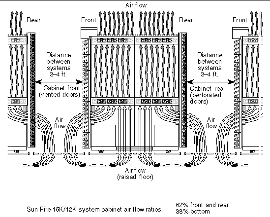

The design of the environmental control system (such as computer room air conditioning units) must ensure that intake air to the system meets the requirements specified in this section. Air enters the cabinet through the access panels and through an air intake that is located underneath the system cabinet. The heated air is exhausted out of the top of the system cabinet. Overheating can occur if warm air is directed underneath a cabinet or toward the access panels. TABLE 2-1 provides the environmental requirements for the Sun Fire 15K/12K systems and the customer selected I/O expansion racks. If the system is significantly colder (40 °F [4 °C] or colder) than the environment in which you will install it, leave the system in its shipping crate at its final destination for 24 hours to prevent thermal shock and condensation.

FIGURE 2-1 demonstrates the directions of the air flow within the system cabinet.

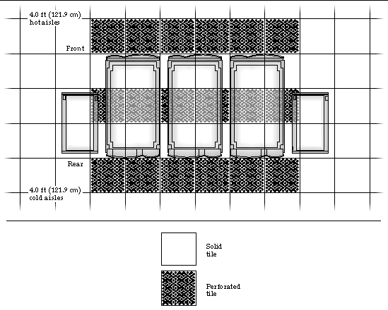

The fan tray redundancy in the Sun Fire 15K/12K systems provide enough air flow for adequate system performance on a flat floor. A raised floor is recommended for optimal system performance. Air enters the cabinet through the front and rear doors and through the air intake panels underneath the cabinet. Review the recommended floor plan layout sample for a fully configured system in FIGURE 2-2 for planning your solid and perforated tile floor configuration. This floor plan is based on floor tiles delivering 600 cubic feet per minute (cfm) cooling for each tile.
FIGURE 2-3 shows a floor plan layout for multiple Sun Fire 15K/12K systems.
