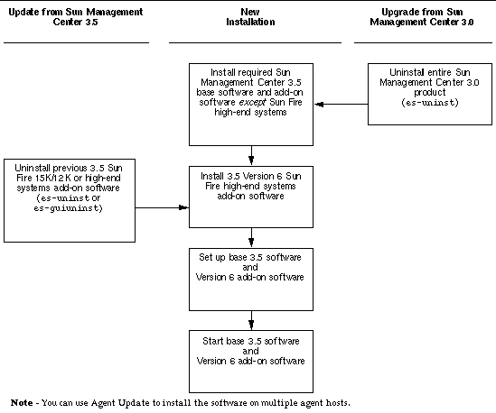

FIGURE 2-1 shows a high-level view of the installation process.
If you are updating existing Sun Management Center 3.5 add-on software for Sun Fire high-end systems, you must:
Note - Before you start, be aware that you can use Agent Update to install Sun Management Center software on multiple agent hosts. For instructions about updating multiple hosts using agent update, see Updating Multiple Hosts Using Agent Update. |

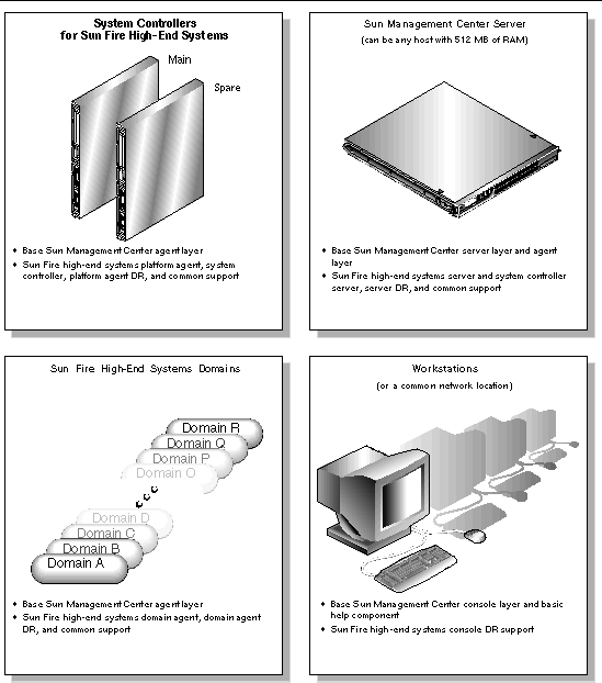

Install and set up the Sun Management Center base server layer and Sun Fire high-end systems and system controller server add-on components on the designated Sun Management Center server machine. The Sun Management Center base agent layer is automatically installed on the Sun Management Center server machine if you install the base server layer. This is so you can monitor the server machine itself.
Following is a summary of the procedures for installing and setting up Sun Management Center software on the system controllers and Sun Fire high-end systems domains:
1. Install and set up the Sun Management Center base agent layer and the Sun Fire high-end systems platform agent and system controller add-on components on the main and spare system controllers.
2. Install and set up the Sun Management Center base agent layer and Sun Fire high-end systems domain agent add-on component for each Sun Fire high-end systems domain you want to monitor.
Install and set up the Sun Management Center base console layer, basic help component, and console DR support on a common network location or on each workstation from which you want to monitor by using the GUI.
For Sun Fire high-end systems support, install and set up the Sun Management Center software on the Sun Fire high-end systems hosts as shown in TABLE 2-4. The Sun Management Center Installation and Configuration Guide provides information about installing and setting up the base software. It also provides instructions for starting and stopping Sun Management Center software.
Note - You can install the Sun Fire high-end and midrange systems Platform Agents on any machine where you have Sun Management Center software running. |

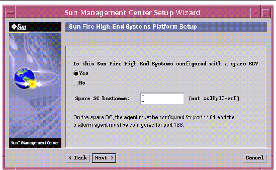

The Sun Fire High-End Systems Platform Setup panel displays the following.
ii. Enter the spare SC hostname.
The Sun Fire High-End Systems Platform Setup panel displays this message.

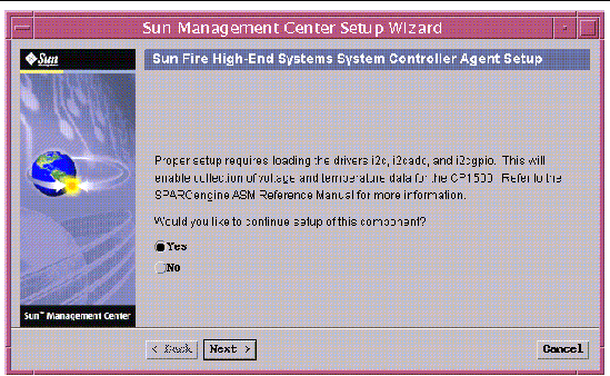

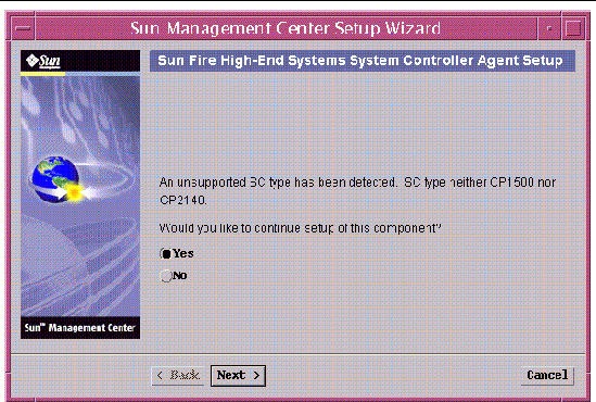

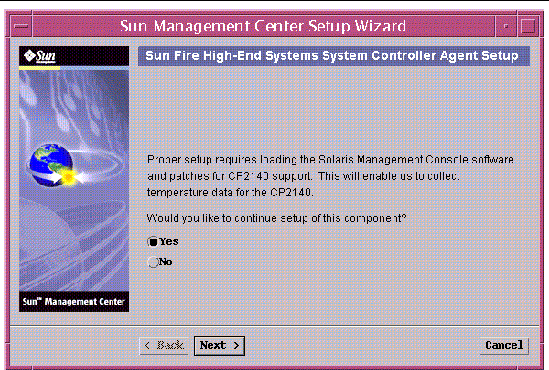

The System Controller Agent Setup panel for Sun Fire high-end systems displays one of the following messages depending on the machine you are using for an SC.
The System Controller Agent Setup panel for Sun Fire high-end systems displays this message.
Updating configuration files... Status: Created deviceinfo.conf file .... Update of configuration files complete. |

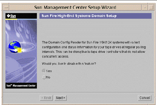

The Sun Fire High-End Systems Domain Setup panel displays the following:
If your tape drive controllers do not allow concurrent access, you will want to disable this feature.
The Sun Fire High-End Systems Domain Setup panel displays the status of updating configuration files.
The Sun Fire High-End Systems Domain Setup panel displays this message.

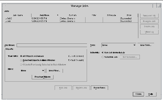

2. From your main Sun Management Center console window, choose the Manage Jobs... option from the Tools menu.
The system displays the Manage Jobs panel (FIGURE 2-9), which allows you to distribute the Image File.
3. In the Manage Jobs panel, select the New Task... button.
The system displays the New Task panel (FIGURE 2-10), which allows you to specify the Agent Update Image File to distribute.
4. In the New Task panel (FIGURE 2-10), do the following:
a. Choose Agent Update for the Task Type.
b. Choose the Image File you created in Step 1.
5. In the Manage Jobs panel (FIGURE 2-9), do the following:
b. Choose the Task you created in Step 4.
c. Do one of the following to schedule when you want the Task to run.
d. Do one of the following to choose the objects (agent machines) to which you want to distribute the Image File.
e. Preview the objects (agent machines) you have chosen and redo your selections if necessary.
The job starts and distributes the Image File to the objects (agent machines) you selected. When the job is running, it appears in the Job list of the Manage Jobs panel. The panel shows the status of the job when running and when complete.
