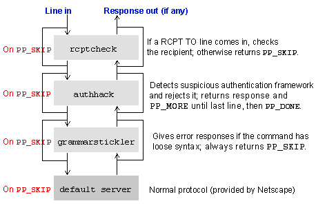

At start-up time, Messaging Server loads and initializes the configured protocol level plug-in module or PPModule. When a connection to the server is established, a new protocol level plug-in session is created. Protocol plug-in modules are loaded in the stack in the order of initialization, with the first plug-in (ProtPlug) on the top and the default server at the bottom.
Each incoming command is passed to the top plug-in for processing. This plug-in can either pass control to the next protocol level plug-in down (defer), make a decision to act on the line in some way, or do nothing. Each plug-in in the calling hierarchy can prevent those below it from being called or change the information that it passes to them.
For example, if the server is configured with the plug-ins libPPMrcptcheck.so, libPPMauthhack.so, and libPPMgrammarstickler.so, the protocol line stack appears as in this diagram:
Figure 1.1    How plug-ins work
In this example, the plug-in libPPMrcptcheck.so is called first, since it is at the top of the stack. The line is passed to each plug-in in turn, until it reaches the default server. At this point, the plug-in calling sequence unwraps by returning to its calling plug-in successively until it reaches the top of the stack again.
