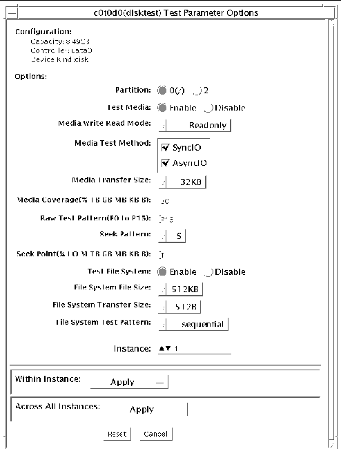

disktest Test Options
To reach the dialog box below, right-click on the test name in the System Map and select Test Parameter Options. If you do not see this test in the System Map, you might need to expand the collapsed groups, or your system may not include the device appropriate to this test. Refer to the SunVTS User's Guide for more details.
Screenshot of the disktest Test Parameter Options dialog box.
FIGURE 8-1 disktest Test Parameter Options Dialog Box
The following table describes the disktest option menu for different test modes.

dev=device_name
Specifies the name of the disk to be tested.
For example: c0t3d0.
The following example shows how to run disktest on a partition "0" (which is mounted under "/") for the disk device c0t0d0. The media subtest is enabled in ReadOnly mode using SyncIO method. The coverage specified is 30% with 512 KB transfer size. The File System subtest is disabled.
# /opt/SUNWvts/bin/disktest -f -o partition=0"(/)", rawsub=Enable, rawrw=ReadOnly, method=SyncIO, rawcover=30, rawiosize=512KB, fssub=Disable, dev=c0t0d0
