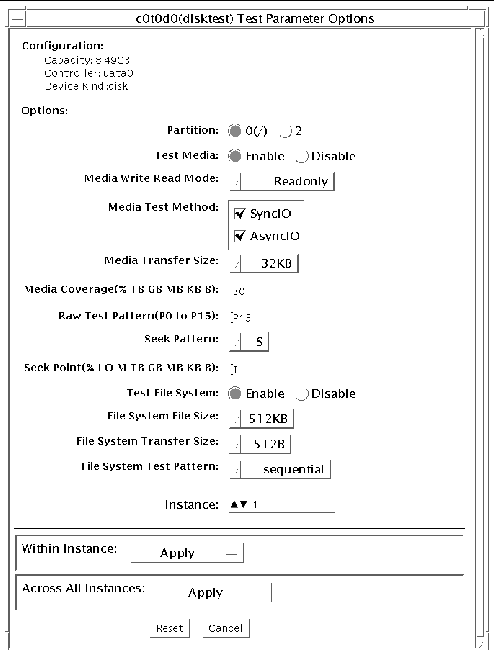

To reach the dialog box below, right-click on the test name in the System Map and select Test Parameter Options. If you do not see this test in the System Map, you might need to expand the collapsed groups, or your system may not include the device appropriate to this test. Refer to the SunVTS User's Guide for more details.
Screenshot of the disktest Test Parameter Options dialog box.
FIGURE 3-1 disktest Test Parameter Options Dialog Box
The following table describes the disktest option menu for different test modes.
TABLE 3-2 disktest Configurations and Options
disktest Options
Description

method=AsyncIO+SyncIO
Specifies the Media access method. You can choose to use either or both methods . If you use both access methods together, you must insert a `+' between the two:
AsyncIO: Runs the asynchronous I/O test, using the async read/write feature of the Solaris disk driver
SyncIO: Runs the synchronous I/O test.
For example: method=AsyncIO
fssub=E(nable)|D(isable)
Enables or disables the File System subtest. File system subtest runs on a mounted partition with a file system.
fspattern=<data_pattern>
Specifies the file system data pattern as sequential or random or one of the patterns selected from the list. {seq(uential)|0x0(0000000)|0xf(fffffff)|0xa (5a5a5a5)| 0x5(a5a5a5a)|ran(dom)|0xd(b6db6db)}
For example:
a) fspattern=0xa
a) fspattern=seq
fssize=<number>{K|KB|M|MB|k|kb|m|mb}
Indicates the file system subtest size in Megabytes or Kilobytes:
- K|k|KB|kb - kilobytes
- M|m|MB|mb - megabytes
512KB|2MB| 8MB| 20MB|100MB|200MB
fsiosize=<number>{K|KB|B|k|kb|b}
Indicates the size of the file system subtest I/O transfer in bytes or Kilobytes:
- B|b - bytes
- K|k|KB|kb - Kilobytes
512B|1024B|10KB|40KB|80KB
dev=device_name
Specifies the name of the disk to be tested.
For example: c0t3d0.
The following example shows how to run disktest on a partition "0" (which is mounted under "/") for the disk device c0t0d0. The media subtest is enabled in ReadOnly mode using SyncIO method. The coverage specified is 30% with 512 KB transfer size. The File System subtest is disabled.
# /opt/SUNWvts/bin/disktest -f -o partition=0"(/)", rawsub=Enable, rawrw=ReadOnly, method=SyncIO, rawcover=30, rawiosize=512KB, fssub=Disable, dev=c0t0d0
