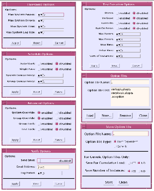

Test messages are displayed in the SunVTS console window, which displays errors and status.
FIGURE 3 displays the SunVTS GUI option menu dialog boxes:
These dialog boxes are displayed from the selections available in the Options Menu.
Note - Use arrows to increase or decrease dialog box values. |
Max System Passes - States maximum number of system passes before stopping all tests (0 means infinite passes).
Run On Error - Continues testing until the maximum error number is reached for the system; each test can report up to three error messages per failure.
System Override - Changes all test and group system options to match the options on this window (enabled by default).
Group Override - Overrides any test system options in favor of the group options on this window, unless System Override is enabled.
Test Lock - Protects the test system options from being changed in this window, unless Group Override or System Override is enabled.
Options File Load/Store/Remove - Displays file name field where you can enter a file name to load, store, or remove.
