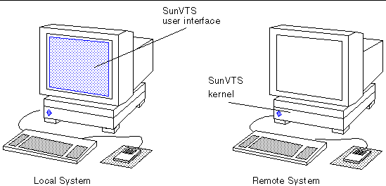

procedure icon  To Connect the User Interface to a Remote System
1. Type the following command:
# /opt/SUNWvts/bin/sunvts -h remote_hostname
Replace remote_hostname with the hostname or IP address of the remote system.
The sunvts command starts the SunVTS kernel (vtsk) on the remote system, and starts the SunVTS user interface on the local system. The user interface connects to the kernel and the displays the test session of the remote system. Refer to FIGURE 3-1 below.
The term system under test (SUT) refers to the system running the SunVTS kernel, which is the remote system in this example.
FIGURE 3-1 SunVTS CDE Main Window
Drawing showing the SunVTS user interface displayed on one workstation and the SunVTS kernel running on another workstation.
Note - If the user interface is already running on your local system, you can use the "Connect to" button to connect to a remote machine SunVTS kernel, provided that the SunVTS security is set up properly.

procedure icon  To Display Devices of a Remote System
Note - The user or local host must be listed in the .sunvts_sec file on the remote system.
1. Make sure that the SunVTS kernel is running on the remote system.
2. Type the following command:
# vtsprobe -h hostname
The vtsprobe utility connects to the remote machine and displays the hardware devices of the remote machine. The output is displayed on the window in which you invoke vtsprobe.
