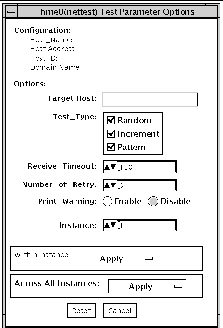

To reach the following dialog box, right-click on the test name in the System Map and select Test Parameter Options. If you do not see this test in the System Map, you might need to expand the collapsed groups, or your system might not include the device appropriate to this test. Refer to the SunVTS User's Guide for more details.
FIGURE 39-1 nettest Test Parameter Options Dialog Box
The Configuration section specifies the host name, host ID, host address, and domain name of the system being tested.
TABLE 39-1 nettest Options
nettest Options
Description
Target Host
Specifies one or more targets to be tested against. Target host entries can be either a host name or an Internet address. When no target host is specified, the test finds necessary targets through broadcasting. The default setting leaves this field empty.
Receive Timeout field
The default is 120 seconds, but can be changed. Use a range from 0 to 600 seconds.
Number of Retries field
The default number of retries before flagging an error is three, but can be changed. Use a range between 0 to 128 retries.
Print Warning
Disabled by default. Click Enable to see warning errors, such as retry on timeout.
