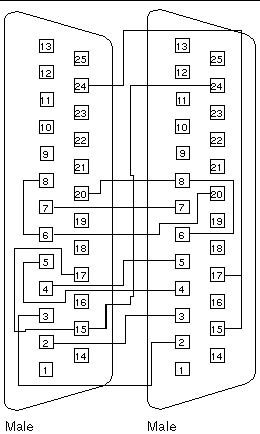

25-Pin RS-232 Port-to-Port Loopback Cable
FIGURE A-2 shows how to connect 25-pin RS-232 and RS-423 port to 25-pin RS 232 and RS 423 port loopback cables (two DB-25 connections). The cable is connected to a pair of serial ports in the back of the system under test. Both plugs are male. The following table lists the pin connections for connecting the first plug to the second plug:
TABLE A-3 25-pin RS-232 Port-to-Port Loopback Cable Wiring Plug Connections
First Plug
Second Plug
Pin 2
Pin 3
Pin 3
Pin 2
Pin 4
Pin 5
Pin 5
Pin 4
Pins 6 and 8
Pin 20
Pin 7
Pin 7
Pins 15 and 17
Pin 24
Pin 20
Pins 6 and 8
Pin 24
Pins 15 and 17
FIGURE A-2 25-pin RS-232 Port-to-Port Loopback Cable Wiring Diagram

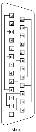

25-Pin Port A-to-Port B Loopback Plug
FIGURE A-5 shows how to connect a 25-pin Port A to Port B loopback plug for most systems. The following table lists the pin connections for connecting the first plug to the second plug:
TABLE A-6 Port A-to-Port B Loopback Plug Wiring Plug Connections
First Plug
Second Plug
Pin 16
Pin 2
Pin 3
Pin 14
Pin 13
Pin 4
Pin 5
Pin 19
Pins 6 and 8
Pin 11
Pin 12
Pin 20
Pin 18
Pin 24
Pins 15 and 17
Pin 25
FIGURE A-5 Port A-to-Port B Loopback Plug Wiring Diagram

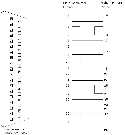

37-Pin RS-449 Loopback Cable
Use these wiring instructions for a loopback cable for two 37-pin RS-449 synchronous ports.
FIGURE A-9 37-Pin RS-449 Loopback Cable Wiring Diagram

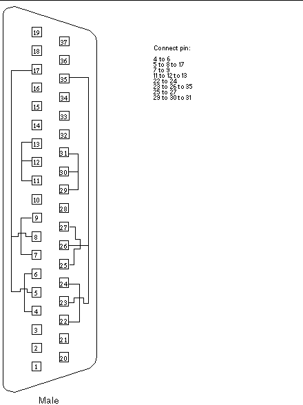

37-Pin RS-449 Loopback Plug
Use these wiring instructions to make a male 37-pin RS-449 loopback plug. This plug is also available from Sun (part number 530-1430).
FIGURE A-10 37-Pin RS-449 Loopback Plug Wiring Diagram

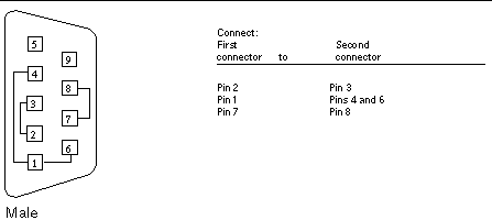

9-Pin Male Single-Port Loopback Plug
Use these wiring instructions for male 9-pin RS-232 and RS-423 single-port loopback plugs.
FIGURE A-11 9-Pin Male Single-Port Loopback Plug Wiring Diagram

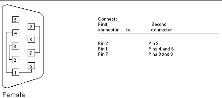

9-Pin Female Single-Port Loopback Plug
Use these wiring directions for female 9-pin RS-232 and RS-423 single-port loopback plugs. Use this loopback plug with the pcmciatest.
FIGURE A-12 9-Pin Female Single-Port Loopback Plug Wiring Diagram

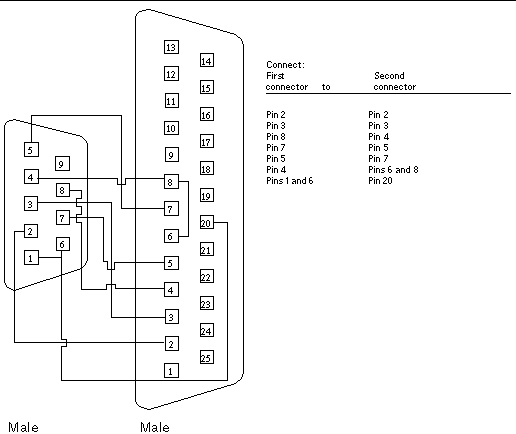

9-Pin to 25-Pin Port-to-Port Loopback Cable
Use these wiring instructions for a 9-pin RS-232 and RS-423 port to 25-pin RS-232 and RS 423 port loopback cables. Both connectors are male.
FIGURE A-13 9-Pin to 25-Pin Port-to-Port Loopback Cable Wiring Diagram

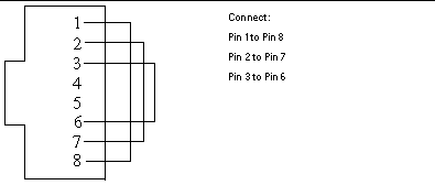

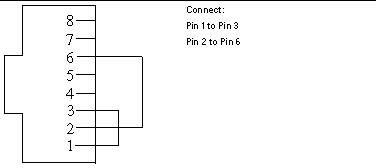

NT to TE Loopback Cable
Using two standard RJ-45 connectors, and connect pin 1 to pin 1, pin 2 to pin 2, and so on, for all pins. This loopback is a straight-through connection.
Twisted-Pair Ethernet (TPE) Loopback Cable for Fast Ethernet
Use the following wiring instructions for standard RJ-45 connectors for Fast Ethernet. Use loopback cable in netlbtest for eri devices.
FIGURE A-15 Twisted-Pair Ethernet (TPE) Loopback Cable Wiring Diagram for Fast Ethernet
TPE Loopback Cable for Gigabit and 10/100 Ethernet
Use the following wiring instructions for RJ-45 plugs for Gigabit and 10/100 Ethernet. This loopback cable is used in netlbtest for Gigabit and 10/100 devices.
FIGURE A-16 TPE Loopback Cable Wiring Diagram for Gigabit and 10/100 Ethernet
FIGURE A-19 9-Pin Female Single-Port Loopback Plug Wiring Diagram

9-Pin Female DB-9 External Loopback Connector
Use these wiring instructions for female 9-pin DB-9 external loopback connectors. Use this loopback connector with the netlbtest on x86 platforms.
FIGURE A-21 9-Pin Female DB-9 External Loopback Connector Wiring Diagram
