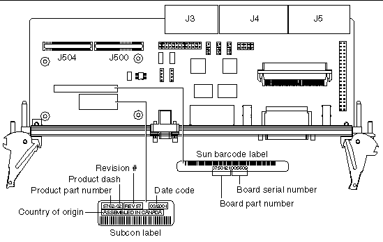

1. The XCP2040-TRN board part number, date code, and revision number are identified on labels. Please see FIGURE 3 for their locations. Before installing the transition card, its board part number (for example, 3750121) must be verified to ensure that the correct transition card is being installed into the CompactPCI system.

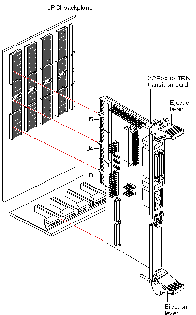

2. Ensure that the XCP2040-TRN is perpendicular to the backplane when it is connected to the backplane pins. Incorrect vertical or angular positioning during board insertion can result in damage to the backplane and subsequent electrical destruction of the transition card and the corresponding Netra host board (see FIGURE 1).

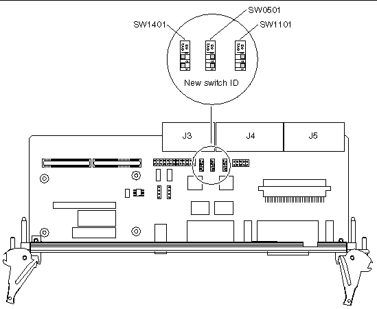

FIGURE 2 shows the single in-line package (SIP) switches on the XCP2040-TRN. For a complete listing of SIP switch settings, see the XCP2040-TRN I/O Transition Card Manual for Netra CP2040 and CP2140 CompactPCI Boards (806-6743-xx).

Please have the board identification information ready (see FIGURE 3). The
XCP2040-TRN board part number, board serial number, and revision number can be found on labels located on the board. For proper identification of the board, please see the list below and FIGURE 3. The Sun Microsystems barcode label provides the following information:
The board also contains the following information on the subcon label:
Caution - Ensure that you are installing an XCP2040-TRN by checking to see that its part number is 3750121, as shown in FIGURE 3. Transition cards built for use with other CompactPCI host boards are not compatible with the Netra CP2040/CP2140 board and may cause damage to themselves, the host, and the backplane if installed. |
