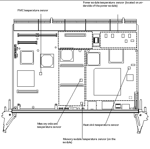

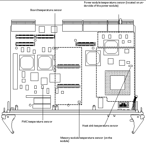

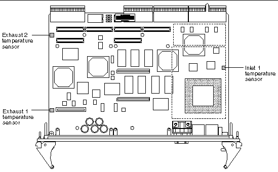

FIGURE 3-2, FIGURE 3-3, FIGURE 3-4 and FIGURE 3-5 show the location of the ASM hardware on the Netra CP2000/CP2100 series boards.

The Netra CP2040/CP2060/CP2080/CP2140 boards use a MAX1617 temperature sensor located near the CPU underneath its heat sink. The Netra CP2160 board does not have this temperature sensor.
The onboard voltage controller allows power to the rest of the Netra CP2000/CP2100 series board only when the following conditions are met:
The controller requires these conditions to be true for at least 100 milliseconds to help ensure the supply voltages are stable. If any of these conditions become untrue, the voltage monitoring circuit shuts down the power of the board.
The inlet board temperature sensor can be used to ensure that the maximum allowable short-term system-level air inlet temperature is not exceeded. The sensor can also be used to monitor potential issues with the system or installation, since inlet temperature for the Netra CP2160 board should be kept low for the installation reliability requirements.
The two exhaust temperature sensors can be used to ensure that the proper airflow across the board is being maintained. The difference in the temperature between the inlet air temperature and exhaust temperatures can be monitored to determine if system filters need servicing, if air movers have failed, or if an electrical problem has occured due to components drawing too much power on the board.

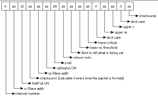

A typical example of the sensor command is as follows:
37 0 41 10 0 0 3 1b 2 26 12 20 34 12 ba 0 10 34 execute-smc-cmd |

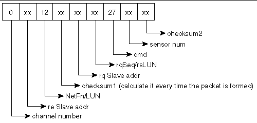

a5 2 27 12 20 34 12 ba 0 9 34 execute-smc-cmd |

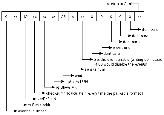

24 0 0 0 0 80 2 28 12 20 34 12 ba 0 e 34 execute-smc-cmd |

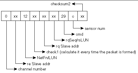

a3 2 29 12 20 34 12 ba 0 9 34 execute-smc-cmd |
Note - The NetFN/LUN for all sensor IPMI commands is 12, which implies that the netFn is 0x04 lun= 0x2. |

For location of thermocouple see FIGURE 3-2, FIGURE 3-3 and FIGURE 3-4 and FIGURE 3-5.
