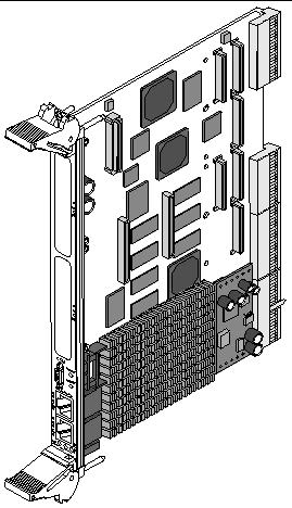

packaging as this will be required for the return of any failed units for repair. If any of the items are missing or damaged, contact your authorized Sun representative indicated in the section Technical Support. The Netra CP2160 board kit contains the following (see FIGURE 1 for an illustration of the Netra CP2160 board):

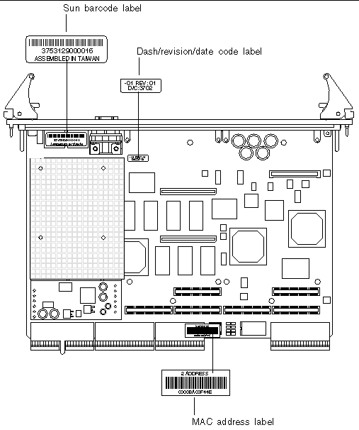

When you call Enterprise Services, be sure to indicate that the Netra CP2160 board was purchased separately and is not associated with a system. Have the board identification information ready when you call. The Netra CP2160 board part number, serial number, and revision can be found on the board labels. For proper identification of the board, see the list below and FIGURE 2.
The Sun barcode label provides the following information (see FIGURE 2):
The Dash/Revision/Date Code label provides the following information (see FIGURE 2):

The serial I2C EEPROM stores the backup copy of the board MAC address and host ID information. The MAC address label is partially on top of the EEPROM and partially on top of the J3 connector (see FIGURE 2). If you need to replace the Netra CP2160 board, remove the Serial I2C EEPROM from the original board and install it on the new CP2160 board. Remove the MAC address label completely from the board when you remove the EEPROM device.
To correctly position the EEPROM device on the board and to precisely install it on the Netra CP2160 board, see Netra CP2160 CompactPCI Board Installation and Technical Reference Manual (816-5772-xx).
