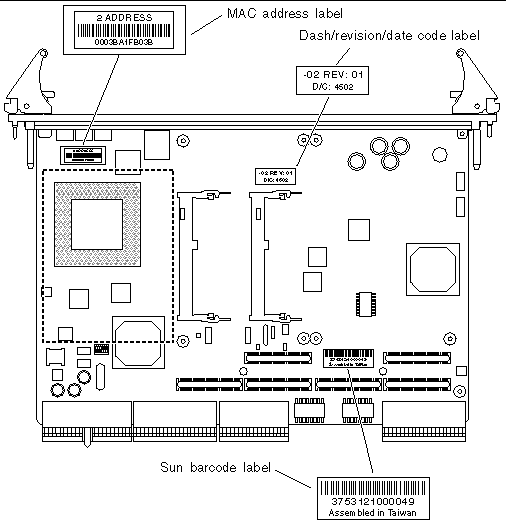

When you call Sun Services, be sure to indicate that the Netra CP2300 board was purchased separately and is not associated with a system. Have the board identification information ready when you call. The Netra CP2300 board part number, serial number, and revision can be found on the board labels. For proper identification of the board, see FIGURE 1 and the following list.
The Sun barcode label provides the following information (see FIGURE 1):
The Dash/Revision/Date Code label provides the following information (see FIGURE 1):
Note - You might find the labels shown in FIGURE 1 on other locations on your board. Also, your particular board configuration may appear different than the illustration above. |

The serial I2C EEPROM stores the board MAC address and host ID information. The MAC address label is between the heat sink and the front panel (FIGURE 1).
If you need to replace the Netra CP2300 board, remove the serial I2C EEPROM from the original board and install it on the new Netra CP2300 board. To position and install the EEPROM correctly on the Netra CP2300 board, refer to the Netra CP2300 cPSB Board Installation and Technical Reference Manual (816-7186-xx).
