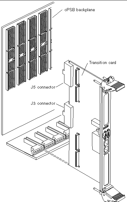

2. Ensure that the Netra CP2300 cPSB transition card is perpendicular to the backplane when it is connected to the backplane pins. Careless vertical or angular positioning during board insertion can result in damage to the backplane and subsequent electrical destruction of the transition card and the corresponding Netra CP2300 board. See FIGURE 1 for an illustration of how to properly align the transition card with the backplane connectors.
