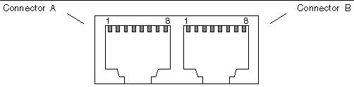

Fast Ethernet Connectors
The dual-jack RJ45 AMP1116353-8 Ethernet connectors, located on the transition card's back panel, provide two 10/100 Mbps fast Ethernet ports.
FIGURE A-3 Fast Ethernet Connector Pins
By default, these Ethernet ports are not available if the Netra CP2300 cPSB board is set to use the chassis's packet-switched backplane (PSB) Ethernet network. In order to use the transition card's Ethernet connectors, you must set the 0 position of the Netra CP2300 board SW503 DIP switch on (see FIGURE A-4). After setting this DIP switch to on, the PSB Ethernet network will not be available, but you will be able to use the transition card's two RJ45 connectors.
FIGURE A-4 Setting the SW503 DIP Switch on the Netra CP2300 cPSB Board
TABLE A-5 lists the pin assignments for the dual-jack RJ45 AMP1116353-8 Fast Ethernet connectors.

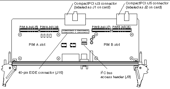

On-Board Interfaces and Connectors on the Netra CP2300 Transition Card
FIGURE A-5 shows the on-board interfaces and connectors on the transition card. The numbers in parentheses display how the interfaces are labeled on the transition card.
FIGURE A-5 Netra CP2300 Transition Card On-Board Connectors and Interfaces
I2C Serial Bus Access Header
The I2C serial bus is routed onto the Netra CP2300 RTM through the rJ5 backplane connector (which is labeled as J2 on the transition card). The Netra CP2300 transition card I2C bus supports one I2C function--provide information about itself through nonvolatile memory. FIGURE A-6 shows the I2C serial bus access header and TABLE A-6 lists the pin assignments.

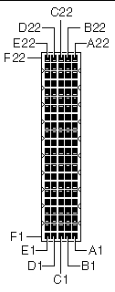

Backplane Interfaces
The Netra CP2300 transition card interfaces to the cPSB bus through the CompactPCI rJ3 (labeled as J1 on the transition card) and rJ5 (J2) backplane connectors. The pin assignments for these two sets of connectors are provided in this section.
CompactPCI rJ3 Connector (J1)
TABLE A-12 shows the pin assignments for the CompactPCI rJ3 connector. This connector is labeled J1 on the transition card (see FIGURE A-5 for the location).
FIGURE A-9 CompactPCI rJ3 Connector (J1) Pins
TABLE A-12 CompactPCI rJ3 Connector (J1) Pin Assignments

Note - The pin assignments for every pin in rows F and Z are ground.
CompactPCI rJ5 Connector (J2)
TABLE A-13 shows the pin assignments for the CompactPCI rJ5 connector. This connector is labeled J2 on the transition card (see FIGURE A-5 for the location).
FIGURE A-10 CompactPCI rJ5 Connector (J2) Pins
TABLE A-13 CompactPCI rJ5 Connector (J2) Pin Assignments
