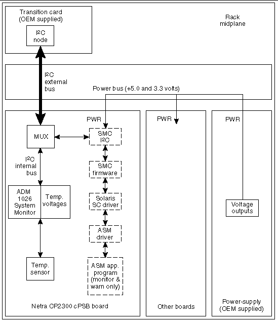

The power module is controlled by the SMC subsystem (except for automatic controls such as overcurrent shutdown or voltage regulation). The functions controlled are core voltage output level and power sequencing/monitor.
The onboard voltage controller is a hardware function that is not controlled by either firmware or software. At the OpenBoot PROM level, if the NVRAM variable env-monitor is set to enabled-with-shutdown (env-monitor=enabled-with-shutdown), and if the board temperature exceeds the shutdown temperature, the OpenBoot PROM will shut down power to the Netra CP2300 cPSB board CPU.
There is no mechanism for the Solaris operating environment to either recover or restore power to the Netra CP2300 cPSB board when an unusual condition occurs (for example, if the CPU diode temperature exceeds its maximum recommended level). In either case, the end user must intervene and manually recover the Netra CP2300 cPSB board as well as the cPSB system through hardware control. Once a shutdown has occurred, you can recover the board using a cold-reset IPMI command to SMC or by extracting and reinserting the board.

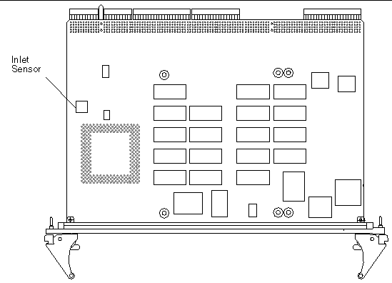

This section summarizes the hardware ASM features on the Netra CP2300 cPSB board. TABLE 3-2 lists the ASM functions on a Netra CP2300 cPSB board.
TABLE 3-3 shows the I2C components.
FIGURE 3-2 and FIGURE 3-3 show the location of the ASM hardware on the Netra CP2300 cPSB board.

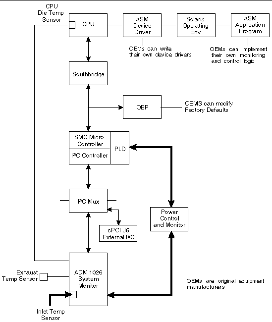

FIGURE 3-4 is a block diagram of the ASM functions.
[ D ]The onboard voltage controller allows power to the CPU of the Netra CP2300 cPSB board only when the following conditions are met:
The controller requires these conditions to be true for at least 100 milliseconds to help ensure the supply voltages are stable. If any of these conditions become untrue, the voltage monitoring circuit shuts down the CPU power of the board.

The inlet sensor measures the local air temperature at the leading edge of the board on the solder-side under the solder-side cover. This value typically can range from a reading of 0°C to 13°C above inlet system ambient in a chassis; care must be taken to understand the application and installation of the board to use this temperature sensor.

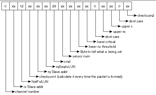

1. Set the thresholds for the sensors.
See Set Sensor Threshold. If no threshold is set, the default threshold operates:
ok packet bytes number-of-bytes-in-packet 34 execute-smc-cmd |
2. Follow instructions in Check Whether the IPMI Commands Are Executed Properly to check proper execution of the command.

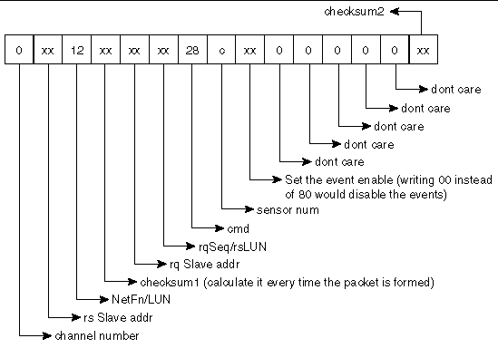

1. To execute a command to enable events from the sensor, type:
See Set Sensor Event Enable Command and Get Sensor Event Enable.

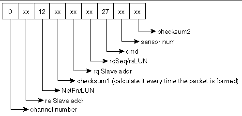

There are supporting commands for any sensor and the corresponding packets at these commands: get sensor threshold, get sensor reading, and get sensor event enable.

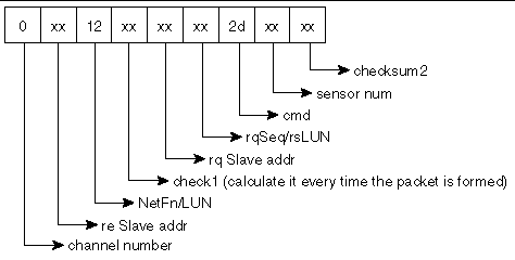

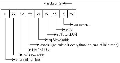

The following packets are IPMI command packets that can be sent from the OpenBoot PROM ok prompt:
A typical example of the sensor command is as follows:
37 0 41 10 0 0 3 1b 0 26 12 20 34 12 ba 0 10 34 execute-smc-cmd |
24 0 0 0 0 80 2 28 12 20 34 12 ba 0 e 34 execute-smc-cmd |
a3 2 29 12 20 34 12 ba 0 9 34 execute-smc-cmd |
Note - The NetFN/LUN for all sensor IPMI commands is 12, which implies that the netFn is 0x04 lun= 0x2. |

The ASM driver is a STREAMS module that sits on top of the Solaris system controller driver. The Netra CP2300 cPSB board ASM driver accepts STREAMS IOCTL input to the ASM driver, passes it onto the system controller driver as a command, and sends the sensor temperature as the output to the user.
Input Output Control with I_STR should be used to get sensor information. The data structure used to pass it as an argument for streams IOCTL is as follows:
When the monitoring is successful, it returns a 0. For any error, it returns -1 and the errno is set correspondingly. Trying to read any sensor which is not physically present sets errno as ENXIO. For any hardware or firmware failures, the errno is EINVAL. For any memory allocation problems, the errno is EAGAIN.
