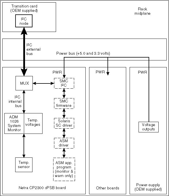

Typical Environmental Monitoring System Application
FIGURE 2-1 illustrates the Netra CP2300 environmental monitoring application block diagram. For locations of the temperature sensors, see FIGURE 2-2 and FIGURE 2-3.
Note - In FIGURE 2-1, ASM refers to the environmental monitoring functionality. The ASM driver is no longer used on the Netra CP2300 board.
FIGURE 2-1 Typical Environmental Monitoring Application Block Diagram
Diagram shows the transition card linking the I2C external bus to the Netra CP2300 board (left); the power bus links other boards (middle), and power supply (right).
The Netra CP2300 functions as a node board in a cPSB system rack. The Netra CP2300 monitors its CPU diode temperature and issues warnings at both the OpenBoot PROM and Solaris operating environment levels when these environmental readings are out of limits. At the Solaris operating environment level, the application program monitors and issues warnings for the board. At the OBP level, the CPU diode temperature is monitored if the NVRAM variable
env-monitor is enabled.

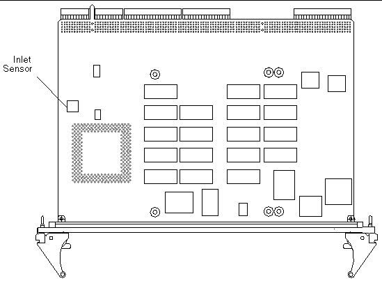

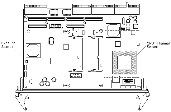

FIGURE 2-2 and FIGURE 2-3 show the location of the environmental monitoring hardware on the Netra CP2300.
FIGURE 2-2 Location of Environmental Monitoring Hardware on the Netra CP2300 cPSB Board (Top Side)
The Netra CP2300 cPSB board shown from the top, with the exhaust sensor on the left and the CPU thermal sensor on the right.The latches are at the bottom of the figure.
FIGURE 2-3 Location of Environmental Monitoring Hardware on the Netra CP2300 cPSB Board (Bottom Side)
The Netra CP2300 cPSB board shown from the bottom, with the inlet sensor on the left; the latches are at the bottom of the figure.

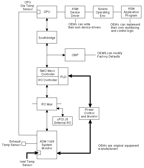

FIGURE 2-4 is a block diagram of the environmental monitoring functions.
Note - In FIGURE 2-4, ASM refers to the environmental monitoring functionality. The ASM driver is no longer used on the Netra CP2300 board. The ASM device driver block in Figure 3-4 should be replaced with SC device driver.
FIGURE 2-4 Netra CP2300 cPSB Board Environmental Monitoring Functional Block Diagram
The diagram shows the ASM functions of the Netra CP2300 cPSB board. [ D ]

The exhaust sensor measures the local air temperature at the trailing edge of the board for systems with bottom to top airflow. This value depends on the character and volume of the airflow across the board. Typical values in a chassis may range from a delta over inlet ambient of 0°C to 12°C, depending on the power dissipation of the board configuration and the position in the chassis. The exhaust sensor is nonlinear with respect to ambient inlet temperature.
The inlet sensor measures the local air temperature at the leading edge of the board on the solder-side under the solder-side cover. This value typically can range from a reading of 0°C to 13°C above inlet system ambient in a chassis; care must be taken to understand the application and installation of the board to use this temperature sensor.

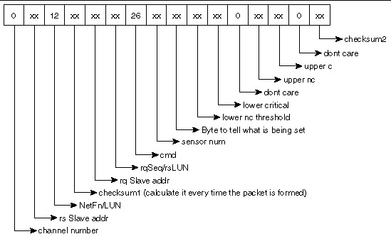

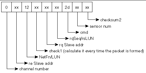

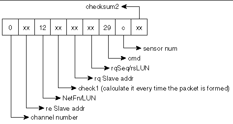

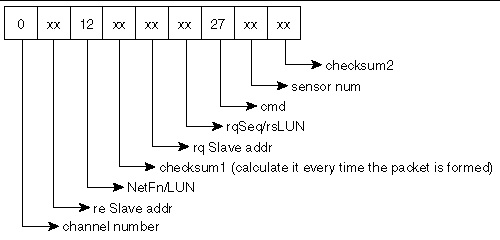

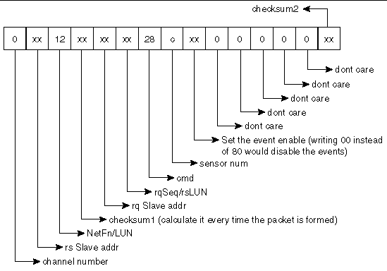

IPMI Command Examples at OpenBoot PROM
The Intelligent Platform Management Interface (IPMI) commands can be used to enable the sensors monitoring and subsequent event generation from other boards in the system.
The IPMI command examples provided in this section are based on the IPMI Specification Version 1.0. Please use the IPMI Specification for additional information on how to implement these IPMI commands.
Note - To execute an IPMI command, at the OpenBoot PROM ok prompt, type the packets in reverse order followed by the relevant information as shown in examples in Examples of IPMI Command Packets. Change the bytes in the example packet to accommodate different IPMI addresses, different threshold values or different sensor numbers. See also the IPMI Specification Version 1.0.
procedure icon  Set or Change the Thresholds for a Sensor
The command execute-smc-cmd is available in SMC controller device mode

Set Sensor Threshold
A typical example of the sensor command is as follows:
37 0 41 10 0 0 3 1b 0 26 12 20 34 12 ba 0 10 34 execute-smc-cmd
Figure showing an example values of the set sensor threshold command.
Note - In byte number 9, if the bit for a corresponding threshold is set to 1, then that threshold is set. If the bit is 0, the System Management Controller ignores that threshold. But if an attempt is made to set a threshold that is not supported, an error is returned in the command response.
Get Sensor Threshold
a5 0 27 12 20 34 12 ba 0 9 34 execute-smc-cmd
Figure showing example values of the get sensor threshold command.
Get Sensor Reading
93 e 2d 12 20 34 12 ba 0 9 34 execute-smc-cmd
Figure showing example values of the get sensor reading command.
Set Sensor Event Enable Command
24 0 0 0 0 80 2 28 12 20 34 12 ba 0 e 34 execute-smc-cmd
Figure showing example values of the set sensor event enable command.
Get Sensor Event Enable
a3 2 29 12 20 34 12 ba 0 9 34 execute-smc-cmd
Figure showing example values of a get sensor event enable command.
Note - The NetFN/LUN for all sensor IPMI commands is 12, which implies that the netFn is 0x04 lun= 0x2.
