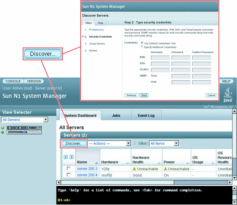

  2. Click the Discover button in the Servers table.
    The Discover Servers wizard appears.
    This graphic shows the
System Dashboard Tab of the browser interface
with the Discover button highlighted.
  3. Use the wizard steps to guide you through the screens.
