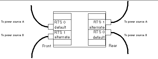

- In configurations with two RTU assemblies and two independent AC power sources there will be four cables to connect, two on the front, and two on the rear of the system (FIGURE 3-1).
FIGURE 3-1 Two RTU Assemblies and Two Independent AC Power Sources

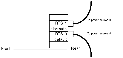

- In configurations with one RTU assembly and two independent AC power sources there will be two cables to connect, both in the rear of the system (FIGURE 3-2).
FIGURE 3-2 One RTU Assembly and Two Independent AC Power Sources

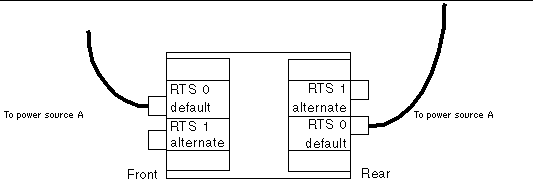

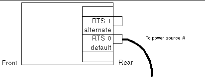

- In configurations with one RTU assembly and one AC power sources there will be only one cable to connect (in the rear of the system on the left) (FIGURE 3-4).
Caution - Connecting the alternate RTS unit to an outlet that uses the same power source as the default RTS unit is not supported and will adversely affect reliability.
FIGURE 3-4 One RTU Assembly and One AC Power Source

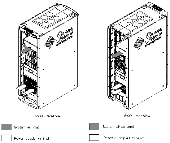

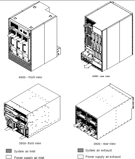

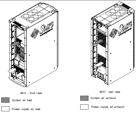

- Any systems mounted in a rack with Sun systems must have front to back cooling (no side to side).
- The front of the cabinet should not be facing, nor be in the path of the exhaust air from any other systems or cabinets.
- It is recommended that the cabinet allow 0.188 cubic meters per second (600 cubic feet per minute) of exhaust air out of the cabinet by way of the exhaust fans located at the top of the cabinet.
- The cabinet must allow for airflow to enter from the front and exhaust to the rear. Do not use a closed cabinet that prevents airflow into the front and out of the rear of the enclosure.
- A cabinet front filler panels must be attached so that no gaps appear between panels and between the panel and the system. If the panels cannot completely fill in the area above the system, make sure the gap appears at the top of the cabinet, away from the system. Cabinet front panels prevent hot air that is expelled from the rear of the cabinet from reentering the system from the front.
- Multiple systems in the same cabinet must be mounted as close together as possible without air gaps in between to avoid exhaust air recirculating back into the front air intake.
- All systems must be mounted in the lowest possible locations within the rack to prevent the cabinet from tipping over.
FIGURE 3-5 Sun Fire 6800 System Air Flow--Front and Rear
FIGURE 3-6 Sun Fire 4810 System Air Flow--Front and Rear
FIGURE 3-7 Sun Fire 4800 and 3800 Systems Air Flow--Front and Rear
