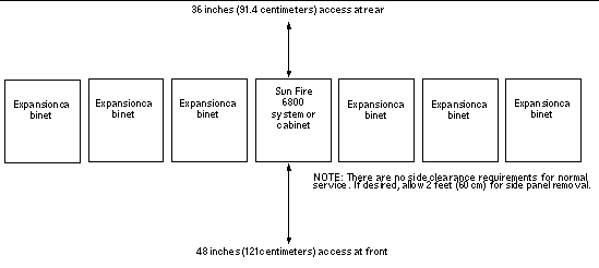

2.2.1 Size and Space Specifications
Sun Fire systems and expansion cabinets can be placed next to each other, without space between them, since there are no side clearance requirements during operation. However, if access is desired, allow approximately 2 feet (60 centimeters) of space on each side to access and remove side panels.

FIGURE 2-5 Sun Fire 6800/4810/4800/3800 Systems Access Areas--Top View
FIGURE 2-6 Sun Fire 4800 System (Deskside) Access Areas--Top View

Access requirement for front
48 in. (122 cm)
Access requirement for rear
36 in. (91 cm)
Air flow requirement for left and right sides
none
