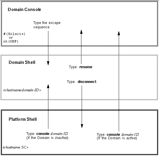

This section describes the navigation procedures summarized in FIGURE 2-1.
Note - This example shows entering an inactive domain from the platform shell. |
where domain_ID is the domain name.
For example, to go to the domain shell for domain a:
If you select a domain that is active (from the SC main menu), you get the domain console instead. An active domain is one in which the OpenBoot PROM is running or the domain keyswitch is set to on, diag, or secure.
Type disconnect to return to the platform shell.
If you choose a domain and that domain is active (the domain keyswitch is set to on, diag, or secure which means you are running the Solaris operating environment, or are in the OpenBoot PROM), you will enter the domain console. To exit the domain console and enter the domain shell, perform the following steps
Type the escape sequence to get to the domain shell prompt.
By default, the escape sequence is #. (the pound sign, followed by a period).
1. If the domain is active, perform the following steps:
a. From the domain shell, type the following:
Note that because the domain is active, you will get a blank line.
b. Press the Return key to get a prompt.
Note - If the domain is not active, (the Solaris operating environment or the OpenBoot PROM is not running), the system controller stays in the domain shell and you will obtain an error. |
2. If the domain is inactive, activate and initialize the domain by typing the following in the domain shell:
The domain console is available only when the domain is active. To make the domain active, you must turn the keyswitch on. You will be automatically switched from the domain shell to the domain console.
The domain will go through POST and then the OpenBoot PROM. If the OpenBoot PROM auto-boot? parameter of the setupdomain command is set to true, the Solaris operating environment will boot. For details on the domain parameters, refer to the setupdomain command description in the Sun Fire Midrange System Controller Command Reference Manual.
