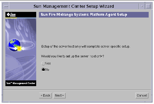

The Sun Fire Midrange Systems Platform Agent Setup panel displays the following message. Go to Step 22.
The Sun Fire Midrange Systems Platform Agent Setup panel displays this message:
The Sun Fire Midrange Systems Platform Agent Setup panel displays the following:

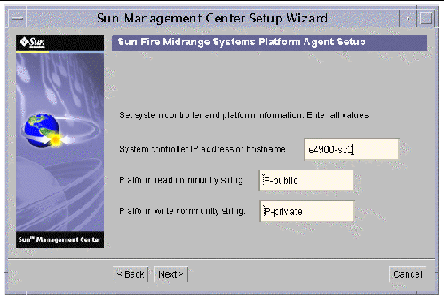

6. Enter a value for each prompt (required):
a. Type the host name or IP address of the System Controller (for example, 10.8.28.209).
Caution - If you want to use the SC failover feature, you must put a logical IP address in this field. Both SCs can then use this logical IP address. Only one SC can use a physical IP address. If you do not put a logical IP address in this field and if a SC failover occurs, you receive a red alarm that the SC is not responding. For information about enabling SC failover and setting up a logical IP address, see To Enable the SC Failover Capability and Set Up a Logical IP Address. |
b. Type the read community string for the platform (for example, P-public).
c. Type the write community string for the platform (for example, P-private).

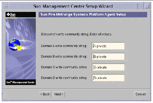

The Sun Fire Midrange Systems Platform Agent Setup panel displays the following message:
a. Type the write community string for domain A, such as A-private
b. Type the write community string for domain B, such as B-private
c. Type the write community string for domain C, such as C-private
d. Type the write community string for domain D, such as D-private

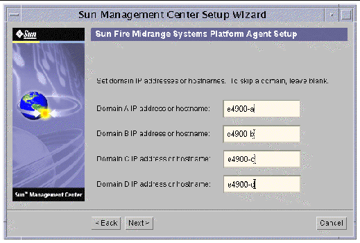

a. Type the IP address or host name of domain A, or leave blank.
b. Type the IP address or host name of domain B, or leave blank.
c. Type the IP address or host name of domain C, or leave blank.
d. Type the IP address or host name of domain D, or leave blank.

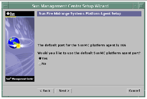

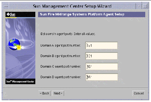

a. Type the Sun Management Center agent port number on domain A.
b. Type the Sun Management Center agent port number on domain B.
c. Type the Sun Management Center agent port number on domain C.
d. Type the Sun Management Center agent port number on domain D.

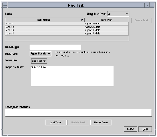

This section describes how to update multiple hosts at once using Agent Update. The Agent Update process itself must be run on the Sun Management Center server machine. You also need to ensure that Sun Management Center 3.5 agents are running on all the target hosts.
To use Agent Update to fully install and set up the Sun Fire Midrange Systems Platform Administration module, you must create an Agent Update configuration file for the module on the target hosts, before you run the Agent Update Process on the Sun Management Center server machine.
1. Ensure the Sun Fire Midrange Systems Platform Administration module is installed on the target hosts.

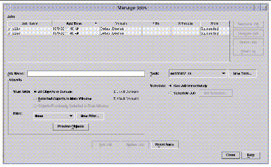

The system displays the Manage Jobs panel (see FIGURE 2-9), which allows you to distribute the Image File.
3. In the Manage Jobs panel, select the New Task... button.
The system displays the New Task panel (see FIGURE 2-10), which allows you to specify the Agent Update Image File to distribute.
4. In the New Task panel (FIGURE 2-10), do the following:
a. Select Agent Update for the Task Type.
b. Select the Image File you created in Step 1.
5. In the Manage Jobs panel (FIGURE 2-9), do the following:
b. Select the Task you created in Step 4.
c. Do one of the following to schedule when you want the Task to run:
d. Do one of the following to select the objects (agent machines) to which you want to distribute the Image File:
e. Preview the objects (agent machines) you have selected and redo your selections if necessary.
The job starts and distributes the Image File to the objects (agent machines) you selected. When the job is running, it appears in the Job list of the Manage Jobs panel. The panel shows the status of the job when running and when complete.
