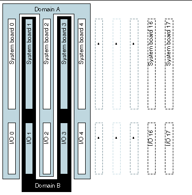

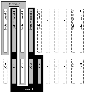

DR lets you disconnect, then reconnect system circuit boards without bringing the system down. You can use DR to add or remove system resources while the system continues to operate.
The example that follows is from a Sun Fire high-end system, but the basic idea applies to midrange systems, as well.
Note - Sun Fire E25K and Sun Fire 15K systems support up to 18 system boards and 18 I/O boards at a time, numbered 0 through 17. |
Domain A contains system boards 0 and 2, and I/O board 2. Domain B contains system boards 1 and 3, and I/O boards 1, 3, and 4.
To assign system board 4 and I/O board 0 to Domain A, and to move I/O board 4 from Domain B to Domain A, you can use the Sun Management Center software's GUI. Or you can use cfgadm(1M) in each domain.
1. Use the following command in Domain B to disconnect I/O board 4.
2. Use the following command in Domain A to assign, connect, and configure system board 4 and I/O boards 0 and 4 into Domain A.
The following system configuration is the result. Only the way in which the boards are connected has changed, not the physical layout of the boards within the cabinet.
