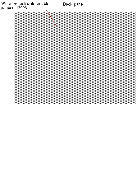

FIGURE 1-2 Sun Ultra 1/Ultra 1 Creator Flash PROM Jumper Location on Motherboard

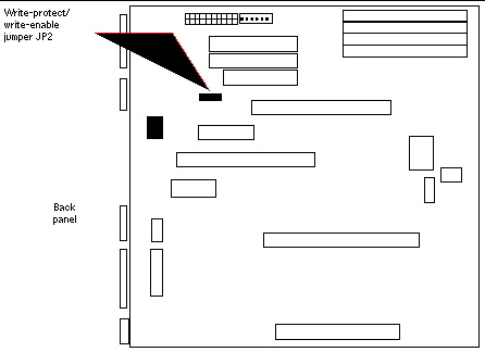

FIGURE 1-4 Sun Ultra 5/Ultra 10 Flash PROM Jumper Location on Motherboard

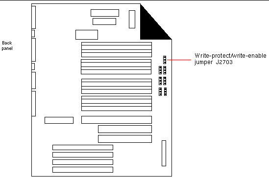

FIGURE 1-5 Sun Ultra 30 Flash PROM Jumper Location on Motherboard

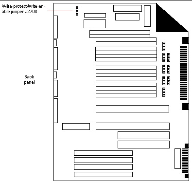

FIGURE 1-6 Sun Ultra 60/Sun Enterprise 220R Flash PROM Jumper Location on Motherboard

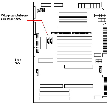

FIGURE 1-7 Sun Ultra 80/Sun Enterprise 420R Flash PROM Jumper Location on Motherboard

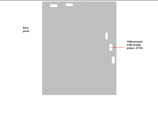

FIGURE 1-8 Sun Enterprise 250 Flash PROM Jumper Location on Motherboard

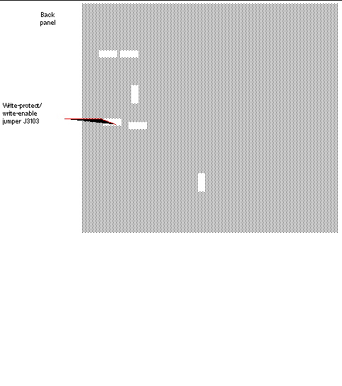

FIGURE 1-9 Ultra Enterprise 450 Flash PROM Jumper Location on Motherboard

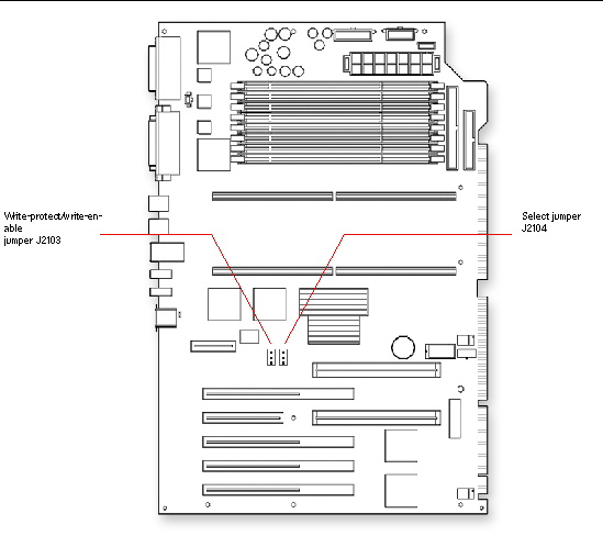

FIGURE 1-11 Sun Blade 1000/Sun Fire 280R/Sun Netra T4 Flash PROM Jumper Location on Motherboard

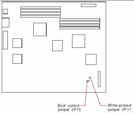

FIGURE 1-12 Sun Fire V210/V240/Sun Netra 240 Flash PROM Jumper Location on Motherboard

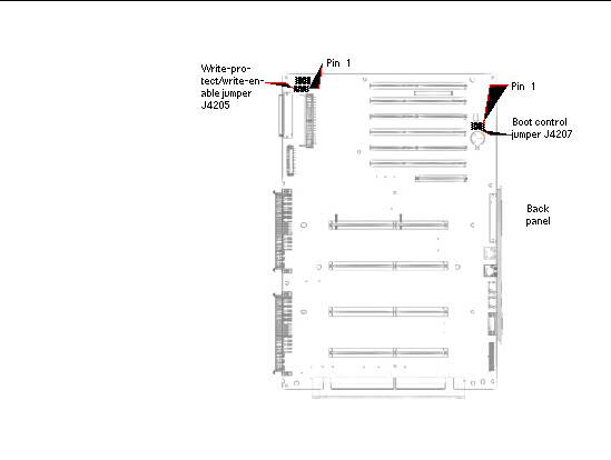

FIGURE 1-13 Sun Fire V440 Flash PROM Jumper Location on Motherboard

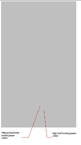

FIGURE 1-15 Sun Fire V880 and Sun Fire V890 Flash PROM Jumper Locations on the System I/O Board 1.3.2 Flash PROM Jumper Settings

Ultra 1, Ultra 1 Creator, and Ultra 2
J2003
Write-protect/
write-enable
Write-protect
Write-enable
1 + 2

Ultra 5 and Ultra 10
JP2
Write-protect/
write-enable
Write-protect
Write-enable
1 + 2
Ultra 30 and Ultra 60/Enterprise 220R
J2703
Write-protect/
write-enable
Write-protect
Write-enable
1 + 2
J2804
Boot control
High-half booting
Normal booting
2 + 3
(see note below)
Do not change the position of jumper J2804 unless directed to do so by the instructions in Appendix . The position of jumper J2804 does not need to be changed unless the programming sequence is interrupted.
Ultra 80/Enterprise 420R
J3001
Write-protect/
write-enable
Write-protect
Write-enable
1 + 2
J3102
Boot control
High-half booting
Normal booting
2 + 3
(see note below)
Do not change the position of jumper J3102 unless directed to do so by the instructions in Appendix . The position of jumper J3102 does not need to be changed unless the programming sequence is interrupted.
Enterprise 250
J2704
Write-protect/
write-enable
Write-protect
Write-enable
2 + 3
(see note* below)

*Jumper J2704 is factory-set so that the flash PROM is write-enabled. You use the keyswitch located on the front panel to write-protect the flash PROM. When the switch is set to the Locked position ( ), the flash PROM is write-protected. When the switch is set to the Power-On position ( ) or to the Diagnostics position ( ), the flash PROM is write-enabled.
**Do not change the position of jumper J2804 unless directed to do so by the instructions in Appendix . The position of jumper J2804 does not need to be changed unless the programming sequence is interrupted.
J3103
Write-protect/
write-enable
Write-protect
Write-enable
2 + 3
(see note* below)
J5501
Boot control
High-half booting
Normal booting
2 + 3
(see note** below)
*Jumper J3103 is factory-set so that the flash PROM is write-enabled. You use the keyswitch located on the front panel to write-protect the flash PROM. When the switch is set to the Locked position ( ), the flash PROM is write-protected. When the switch is set to the Power-On position ( ) or to the Diagnostics position ( ), the flash PROM is write-enabled.
**Do not change the position of jumper J5501 unless directed to do so by the instructions in Appendix . The position of jumper J5501 does not need to be changed unless the programming sequence is interrupted.
JP11
Write-protect/
write-enable
Write-protect
n/a
1 + 2
(see note* below)
JP13
Boot control
Normal booting
High-half booting
1 + 2
(see note** below)
*Jumper JP11 is factory-set so that the flash PROM is write-enabled. You use the keyswitch located on the front panel to write-protect the flash PROM. When the switch is set to the Locked position ( ), the flash PROM is write-protected. When the switch is set to the Power-On position ( ) or to the Diagnostics position ( ), the flash PROM is write-enabled.
**Do not change the position of jumper JP13 unless directed to do so by the instructions in Appendix . The position of jumper JP31 does not need to be changed unless the programming sequence is interrupted.
Sun Fire V440
J4205
Write-protect/
write-enable
Write-protect
Write-enable
2 + 3
(see note* below)
J4207
Boot control
High-half booting
Normal booting
2 + 3
(see note** below)
*Jumper J4205 is factory-set so that the flash PROM is write-enabled. You use the keyswitch located on the front panel to write-protect the flash PROM. When the switch is set to the Locked position ( ), the flash PROM is write-protected. When the switch is set to the Power-On position ( ) or to the Diagnostics position ( ), the flash PROM is write-enabled.
**Do not change the position of jumper J4207 unless directed to do so by the instructions in Appendix . The position of jumper J4207 does not need to be changed unless the programming sequence is interrupted.

J3002
Boot control
High-half booting
Normal booting
2 + 3
(see note** below)
*Jumper J3003 is factory-set so that the flash PROM is write-enabled. You use the keyswitch located on the front panel to write-protect the flash PROM. When the switch is set to the Locked position ( ), the flash PROM is write-protected. When the switch is set to the Power-On position ( ) or to the Diagnostics position ( ), the flash PROM is write-enabled.
**Do not change the position of jumper J3002 unless directed to do so by the instructions in Appendix . The position of jumper J3002 does not need to be changed unless the programming sequence is interrupted.
Sun Blade 1000/Sun Fire 280R and Sun Netra T4
J2103
Write-protect
Write-enable
2 + 3
Flash PROM program enable
J2104
Select
No Select
2 + 3
X or Logic Set
