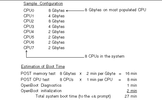

Note - The standard (default) configuration does not increase system boot time after a reset that is initiated by user commands from OpenBoot (reset-all or boot) or from Solaris (reboot, shutdown, or init).
The visible changes are due to the default settings of two configuration variables, diag-level (max) and verbosity (normal):
- diag-level (max) specifies maximum diagnostic testing, including extensive memory testing, which increases system boot time. See Reference for Estimating System Boot Time (to the ok Prompt) for more information about the increased boot time.
- verbosity (normal) specifies that diagnostic messages and information will be displayed, which usually produces approximately two screens of output. See Reference for Sample Outputs for diagnostic output samples of verbosity settings min and normal.

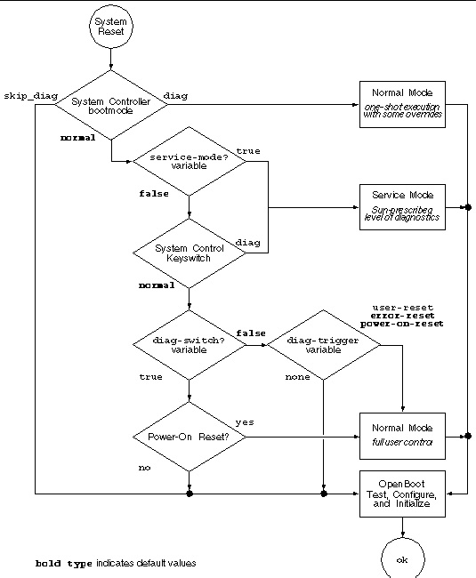

About Service Mode
Service mode is an operational mode defined by Sun that facilitates fault isolation and recovery of systems that appear to be nonfunctional. When initiated, service mode overrides the settings of key OpenBoot configuration variables.
Note that service mode does not change your stored settings. After initialization (at the ok prompt), all OpenBoot PROM configuration variables revert to the user-defined settings. In this way, you or your service provider can quickly invoke a known and maximum level of diagnostics and still preserve your normal mode settings.
TABLE 2 lists the OpenBoot configuration variables that are affected by service mode and the overrides that are applied when you select service mode.
TABLE 2 Service Mode Overrides
OpenBoot Configuration Variable
auto-boot?
false
diag-level
max
diag-trigger
power-on-reset error-reset user-reset
input-device
Factory default
output-device
Factory default
verbosity
max
The following apply only to systems with firmware that contains OpenBoot Diagnostics:
diag-script
normal
test-args
subtests,verbose
About Initiating Service Mode
The enhancements provide two mechanisms for specifying service mode:
- service-mode? configuration variable - When set to true, initiates service mode. (Service mode should be used only by authorized Sun service providers.)
Note - The diag-switch? configuration variable should remain at the default setting (false) for normal operation. To specify diagnostic testing for your operating environment, see How to Initiate Normal Mode.
- Panel keyswitch - When set to the Diagnostics position, initiates service mode.
Note - Not all systems are equipped with a panel keyswitch.
For instructions, see How to Initiate Service Mode.
About Overriding Service Mode Settings
When the system is in service mode, three commands can override service mode settings. TABLE 3 describes the effect of each command.
TABLE 3 Scenarios for Overriding Service Mode Settings
Command
Issued From
What It Does
post
ok prompt
OpenBoot firmware forces a one-time execution of normal mode diagnostics.
bootmode diag
system controller
OpenBoot firmware overrides service mode settings and forces a one-time execution of normal mode diagnostics.1
bootmode skip_diag
system controller
OpenBoot firmware suppresses service mode and bypasses all firmware diagnostics.1
Note - Not all systems are equipped with a system controller.

About Initiating Normal Mode
If you define normal mode for your environment, you can specify normal mode by either of the following methods:
- Panel keyswitch and service-mode? variable - When you set the panel keyswitch to the Normal or Locked position and the OpenBoot configuration variable service-mode? to false, this specifies normal mode.
- System controller bootmode diag command - When you issue this command, it specifies normal mode with the configuration values defined by you--with the following exceptions:
- If you defined diag-level = off, bootmode diag specifies diagnostics at diag-level = min.
- If you defined verbosity = none, bootmode diag specifies diagnostics at verbosity = min.
Note - The next reset cycle must occur within 10 minutes of issuing the
bootmode diag command or the bootmode command is cleared and normal mode is not initiated.
For instructions, see How to Initiate Normal Mode.
The measurement of system boot time begins when you power on (or reset) the system and ends when the OpenBoot ok prompt appears. During the boot time period, the firmware executes diagnostics (POST and OpenBoot Diagnostics) and performs OpenBoot initialization. The time required to run OpenBoot Diagnostics and to perform OpenBoot setup, configuration, and initialization is generally similar for all systems, depending on the number of I/O cards installed when
diag-script is set to all. However, at the default settings (diag-level = max and verbosity = normal), POST executes extensive memory tests, which will increase system boot time.
System boot time will vary from system-to-system, depending on the configuration of system memory and the number of CPUs:
- Because each CPU tests its associated memory and POST performs the memory tests simultaneously, memory test time will depend on the amount of memory on the most populated CPU.
- Because the competition for system resources makes CPU testing a less linear process than memory testing, CPU test time will depend on the number of CPUs.
If you need to know the approximate boot time of your new system before you power on for the first time, the following sections describe two methods you can use to estimate boot time:
Boot Time Estimates for Typical Configurations
The following are three typical configurations and the approximate boot time you can expect for each:
- Small configuration (2 CPUs and 2 Gbytes of memory) - Boot time is approximately 5 minutes.
- Medium configuration (4 CPUs and 16 Gbytes of memory) - Boot time is approximately 10 minutes.
- Large configuration (8 CPUs and 64 Gbytes of memory) - Boot time is approximately 25 minutes.
Estimating Boot Time for Your System
Generally, for systems configured with default settings, the times required to execute OpenBoot Diagnostics and to perform OpenBoot setup, configuration, and initialization are the same for all systems:
- 1 minute for OpenBoot Diagnostics testing might require more time for systems with a greater number of devices to be tested.
- 2 minutes for OpenBoot setup, configuration, and initialization
To estimate the time required to run POST memory tests, you need to know the amount of memory associated with the most populated CPU. To estimate the time required to run POST CPU tests, you need to know the number of CPUs. Use the following guidelines to estimate memory and CPU test times:
- 2 minutes per Gbyte of memory associated with the most populated CPU
- 1 minute per CPU
The following example shows how to estimate the system boot time of a sample configuration consisting of 8 CPUs and 32 Gbytes of system memory, with 8 Gbytes of memory on the most populated CPU.

Reference for Determining Diagnostic Mode
The flowchart in FIGURE 1 summarizes graphically how various system controller and OpenBoot variables affect whether a system boots in normal or service mode, as well as whether any overrides occur.
FIGURE 1 Diagnostic Mode Flowchart
