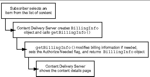

1. When a subscriber requests the details for an item, the Content Delivery Server creates the initial BillingInfo object for the subscriber's selection based on information in the Content Delivery Server database.
2. The Content Delivery Server then calls the billing adapter's getBillingInfo() method and passes the BillingInfo object to the method.
3. Your implementation of getBillingInfo() can modify the purchase price or other details of the transaction, if needed. You can also specify if authorization is needed at the time of purchase and if you want a confirmation message when the content is successfully downloaded. These details are set in the BillingInfo object returned to the Content Delivery Server. See Section 3.2.4, getBillingInfo() for additional information.
4. The Content Delivery Server uses the returned BillingInfo object to show the content details and pricing information for the selected item to the subscriber.

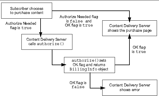

1. When the subscriber chooses to purchase the content, the Content Delivery Server checks the BillingInfo object returned by getBillingInfo() to see if authorization is required.
2. If authorization is required, the Content Delivery Server calls the billing adapter's authorize() method and passes the BillingInfo object. This method is expected to determine if the subscriber is allowed to purchase the content and set the OK flag in the BillingInfo object. That object is then returned to the Content Delivery Server. See Section 3.2.1, authorize() for additional information.
3. If the subscriber is authorized to purchase the content, or no authorization is needed, the purchase page is presented. If the subscriber is not authorized to purchase the content, an error message is issued.
When a subscriber purchases content, the BillingInfo object associated with the transaction is stored in the Content Delivery Server database. For any further actions that require the billing information, the Content Delivery Server retrieves the object from the database using the subscriber ID and content ID as the key.

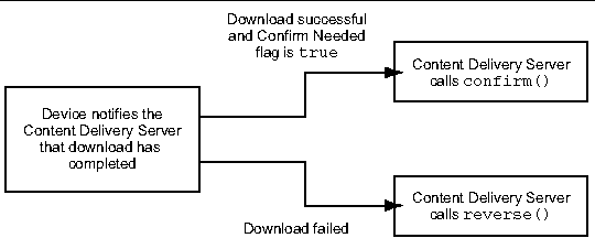

1. When the Content Delivery Server receives confirmation from the device that a download was successful, the Content Delivery Server checks the billing information to see if the billing system wants to be notified of the confirmation.
2. If confirmation is required, the Content Delivery Server calls the billing adapter's confirm() method. See Section 3.2.3, confirm() for additional information.
3. If the device returns an error instead of a successful confirmation, the Content Delivery Server calls the billing adapter's reverse() method and passes the BillingInfo object for this transaction. Code your implementation of reverse() to ensure that the subscriber is not charged for the content that was not downloaded. See Section 3.2.8, reverse() for additional information.
