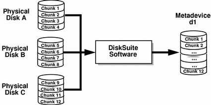

Example -- Concatenated Metadevice
Figure 2-1 illustrates a concatenated metadevice made of three slices (disks).
The data blocks, or chunks, are written sequentially across the slices, beginning with Disk A. Disk A can be envisioned as containing logical chunks 1 through 4. Logical chunk 5 would be written to Disk B, which would contain logical chunks 5 through 8. Logical chunk 9 would be written to Drive C, which would contain chunks 9 through 12. The total capacity of metadevice d1 would be the combined capacities of the three drives. If each drive were 2 Gbytes, metadevice d1 would have an overall capacity of 6 Gbytes.
Figure 2-1 Concatenation Example

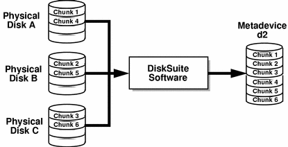

Example -- Striped Metadevice
Figure 2-2 shows a striped metadevice built from three slices (disks).
When DiskSuite stripes data from the metadevice to the slices, it writes data from chunk 1 to Disk A, from chunk 2 to Disk B, and from chunk 3 to Disk C. DiskSuite then writes chunk 4 to Disk A, chunk 5 to Disk B, chunk 6 to Disk C, and so forth.
The interlace value sets the size of each chunk. The total capacity of the striped metadevice d2 equals the number of slices multiplied by the size of the smallest slice. (If each slice in the example below were 2 Gbytes, d2 would equal 6 Gbytes.)
Figure 2-2 Striped Metadevice Example
