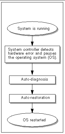

FIGURE 7-1 Auto Diagnosis and Recovery Process
[ D ]
The following summary describes the process shown in FIGURE 7-1:
1. The SC detects hardware error and pauses the operating system.
2. Auto-diagnosis. The AD engine analyzes the hardware error and determines which field-replaceable units (FRUs) are associated with the hardware error.
The AD engine provides one of the following diagnosis results, depending on the hardware error and the components involved:
- Identifies a single FRU that is responsible for the error.
- Identifies multiple FRUs that are responsible for the error. Be aware that not all components listed may be faulty. The hardware error could be related to a smaller subset of the components identified.
- Indicates that the FRUs responsible for the error cannot be determined. This condition is considered to be "unresolved" and requires further analysis by your service provider.
The AD engine records the diagnosis information for the affected components and maintains this information as part of the component health status (CHS).
The AD reports diagnosis information through console event messages.
- CODE EXAMPLE 7-1 shows an auto-diagnosis event message that appears on the console. In this example, a single FRU is responsible for the hardware error. See Reviewing Auto-Diagnosis Event Messages for details on the AD message contents.
CODE EXAMPLE 7-1 Example of Auto-Diagnosis Event Message Displayed on the Console
[AD] Event: E2900.ASIC.AR.ADR_PERR.10473006
CSN: DomainID: A ADInfo: 1.SCAPP.17.0
Time: Fri Dec 12 09:30:20 PST 2003
FRU-List-Count: 2; FRU-PN: 5405564; FRU-SN: A08712; FRU-LOC: /N0/IB6
FRU-PN: 5404974; FRU-SN: 000274; FRU-LOC: /N0/RP2
Recommended-Action: Service action required
Note - Contact your service provider when you see these auto-diagnosis messages. Your service provider will review the auto-diagnosis information and initiate the appropriate service action.
The output from these commands supplements the diagnosis information presented in the event messages and can be used for additional troubleshooting purposes.
3. Auto-restoration. During the auto-restoration process, POST reviews the component health status of FRUs that were updated by the AD engine. POST uses this information and tries to isolate the fault by deconfiguring (disabling) any FRUs from the domain that have been determined to cause the hardware error. Even if POST cannot isolate the fault, the system controller then automatically reboots the domain as part of domain restoration.
