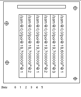

This section describes the PCI I/O assembly slot assignments and provides an example of the device path.
The following code example gives a breakdown of a device tree entry for a SCSI disk:
isptwo is the SCSI host adapter
TABLE 10-5 lists, in hexadecimal notation, the slot number, I/O assembly name, device path of each I/O assembly, the I/O controller number, and the bus.
w = onboard LSI1010R SCSI controller
x = onboard CMD646U2 EIDE controller
y = onboard Gigaswift Ethernet controller 0
z = onboard Gigaswift Ethernet controller 1
and * is dependent upon the type of PCI card installed in the slot.
where * is dependent upon the type of PCI card installed in the slot.
These would generate device paths as follows:

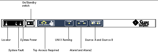

A system fault is any condition that is considered to be unacceptable for normal system operation. When the system has a fault, the Fault LED (
The indicator states are shown in TABLE 10-6. You must take immediate action to eliminate a system fault.
Fault indicator lit when fault detected[1] |
All power supply indicators are lit by the power supply hardware. There is also a predicted fault indicator. Power supply EEPROM errors do not cause degraded state as there is no indicator control. |

One indication of problems might be overtemperature of one or more components. Use the showenvironment command to list current status.
Each power supply unit (PSU) has its own LEDs as follows:
In addition there are two system LEDs labelled SourceA and SourceB. These show the state of the power feeds to the system. There are four physical power feeds and they are split into A and B.
Feed A supplies PS0 and PS1, feed B supplies PS2 and PS3. If either PS0 or PS1 receives input power then the SourceA indicator is lit. If either PS2 or PS3 receives input power then the SourceB indicator is lit. If neither of the supplies receives input power, the indicator is turned off.
These indicators are set on the basis of periodic monitoring at least once every 10 seconds.
