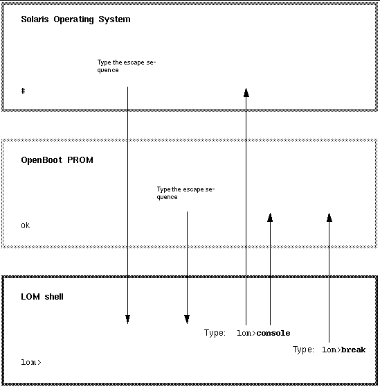

The SC console connection provides access to the SC LOM command line interface, the Solaris OS, and the OpenBoot PROM.
This section describes the procedures to navigate between the following:
These procedures are summarized in FIGURE 3-1
To Break to the LOM Prompt |
When connected to the Solaris console, typing the escape sequence will take the console into the LOM prompt.
By default the escape sequence is set to `#.'. That is, a # sign followed by a period.
For instance, if the escape sequence is the default of #. you will see:
When you type the first character of the escape sequence, there is a one second delay before the character appears on the screen. This is because the system waits to see if the next character in the escape sequence is about to be typed. The second character must be typed within this one-second window. If all the characters in the escape sequence are typed then the lom> prompt appears. If the next character to be typed is not the next character in the escape sequence, then the characters belonging to the escape sequence that were typed are output to the screen.
Choose an escape sequence that does not start with a sequence of characters that is frequently typed at the console, otherwise the delay between your striking the keys and the character appearing on the screen may be confusing.
To Connect to the Solaris Console From the LOM Prompt |
Use the console command from the LOM prompt, then type a carriage return.
If Solaris software is running, the system responds with the Solaris prompt:
If the system was in the OpenBoot PROM, then the system responds with the OpenBoot PROM prompt:
If the system is in Standby mode, the following message is generated:
To Break to the LOM Prompt From the OpenBoot PROM |
The process of moving from the OpenBoot PROM to the LOM prompt is the same as moving from Solaris OS to the LOM prompt.
Type the sequence of escape characters (default #.).
To Break to the OpenBoot Prompt When Solaris Is Running |
When the Solaris Operating System is running the usual effect of sending a break signal to the console is to force entry to the OpenBoot PROM or kernel debugger.
Do this by using the break command from the LOM prompt:
lom>break This will suspend Solaris. Do you want to continue? [no] y Type `go' to resume debugger entered. {1} ok |
To Terminate a Session if You Are Connected to the System Controller Through the Serial Port |
To Terminate a Session If You Are Connected to the System Controller with a Network Connection |
If you are at the Solaris prompt or the OpenBoot PROM, go to the LOM prompt by typing the escape sequence and terminate the LOM prompt session by using the logout command.
The remote session (SSH or Telnet, depending upon the setting chosen using the setupnetwork command) terminates automatically:
