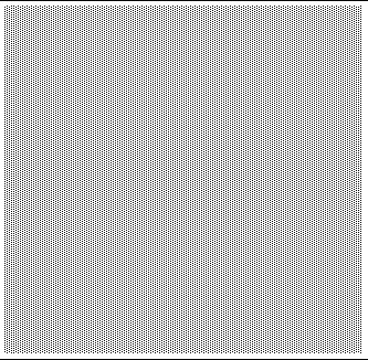

System LEDs
The system LEDs are located behind the front fascia, immediately to the right of the ON/STBY switch as you face the unit, as shown in FIGURE 6-1.
Light pipes transmit the Power, System, Alarm1, Alarm2 and Fault LEDs through the fascia and are visible from the front of the system. To view the remaining LEDs, you must lower the front fascia.
The Alarm1, Alarm2, System and Fault LEDs are mirrored on the LOMlite2 card visible from the rear of the system (see LOMlite 2 LEDs).
FIGURE 6-1 Front Panel System LEDs
TABLE 6-1 Front Panel System LED Functions
LED
Icon
Color
Function
Power
Green
Illuminated continuously while power is supplied to the system.
System
SYSTEM
Green
Off (or reset) during power up procedures and illuminated when UNIX is running and the Alarms driver is installed. This LED is reset by a hardware Watchdog timeout, or whenever the user-defined Alarm3 is asserted.
Alarm11
ALARM1
Amber
Illuminated whenever the user-defined Alarm1 is asserted
Alarm21
ALARM2
Amber
Illuminated whenever the user-defined Alarm2 is asserted
Input A OK
DC-A
Green
Illuminated when the input voltage from feeder A is above 37 V
Off when Input A is below 35 V
Not used in the AC version
Input B OK
DC-B
Green
Illuminated when the input voltage from feeder B is above 37 V
Off when Input B is below 35 V
Fault1
Amber
Driven by the LOMlite2 module under identified system fault conditions
Disk0 Active
Green
Illuminated when Disk0 is active
Disk0 OK to Remove2
Blue
Illuminated, in response to a user request, when Disk0 can be removed safely without affecting the system operation
Disk0 Fault2
Amber
Illuminated when the system has identified a fault in Disk0
Disk1 Active2
Green
Illuminated when Disk1 is active
Disk1 OK to Remove2
Blue
Illuminated, in response to a user request, when disk1 can be removed safely without affecting the system operation
Disk1 Fault2
Amber
Illuminated when the system has identified a fault in Disk1

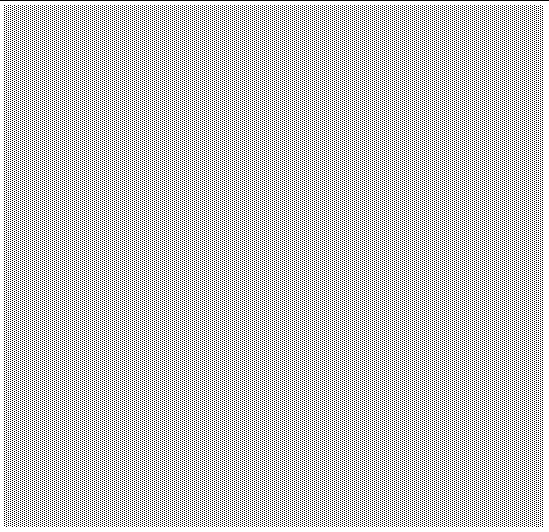

LOMlite 2 LEDs
The LOMlite2 status LEDs, which mirror the alarm status and power LEDs on the front panel, are located on the rear of the system, between the LOMlite2 DB-15 alarm relay port and RJ45 serial port, as shown in FIGURE 6-2.
TABLE 6-2 LOMlite2 Status LED Functions
LED
Legend
Color
Function
Alarm 1
1
Amber
Illuminated when user-defined Alarm 1 is asserted
Alarm 2
2
Amber
Illuminated when user-defined Alarm 2 is asserted
Fault
Amber
Driven by the LOMlite 2 card and illuminated when a system fault condition exists
System
SYS
Green
Illuminated when Solaris is running and the LOMlite2 driver is installed
Off while the system is powering up
Reset by watchdog timeout, assertion of user-defined Alarm 3
FIGURE 6-2 LOMLite2 Status LEDs

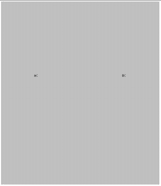

PSU LEDs
The PSU status LEDs are located at the left hand end of the PSU.
Netra 20 AC System
TABLE 6-3 PSU Status LED Functions (Netra 20 AC System)
LED
Icon
Color
Function
AC Input OK
Green
Illuminated when AC is present and above 85 VAC
PSOK
Green
Illuminated when output voltages are within operating range
Flashes when PSU is in Standby mode
Fail
Amber
Illuminated when PSU is in a Fault condition or has shutdown
Off when PSU is enabled (OK)
Flashes if unit is within 10°C of thermal shutdown
FIGURE 6-3 PSU Status LEDs (Netra 20 AC System)

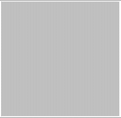

Netra 20 DC System
TABLE 6-4 PSU Status LED Functions (Netra 20 DC System)
LED
Icon
Color
Function
Fail
Amber
Off when PSU is not enabled (OK)
Flashes if unit is within 10°C of thermal shutdown or has shutdown
PSOK
Green
Input B OK
B
Green
Illuminated when input voltage from feeder B is above 37 V
Input A OK
A
Green
Illuminated when input voltage from feeder A is above 37 V
FIGURE 6-4 PSU Status LEDs (Netra 20 DC System)
