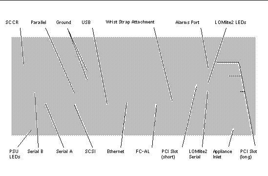

FIGURE 4-1 shows the locations of the Netra 20 system rear panel connectors.
FIGURE 4-1 Rear Panel Connectors (AC System Shown)

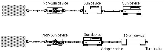

SCSI-2 (UltraSCSI) External Devices
If you connect SCSI-2 (UltraSCSI, 40 Mb data transfer rate) external devices to a Netra 20 system, follow these cabling and configuration guidelines (as shown in FIGURE 4-5) to ensure proper device addressing and operation:
- If all external mass storage devices use 68-pin connectors, connect all non Sun devices to the Netra 20 system first and follow them with Sun devices. Sun devices use auto-termination.
- If external mass storage devices consist of 68-pin Sun devices and 50-pin devices, connect the Sun 68-pin devices to the Netra 20 system first and terminate the daisy chain with the 50-pin device and its terminator.
- The total SCSI bus length for all external SCSI devices is 6.0m (19.7ft), including the internal cabling.
FIGURE 4-5 Connecting External Mass Storage Devices
