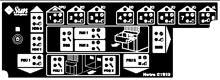

The system status panel is a module designed to give feedback on the status of the key components within the Netra CT server. The system status panel has one set of LEDs for each component within that particular server. FIGURE 3-1 shows the LEDs on the system status panel for the Netra CT 810 server, and FIGURE 3-2 shows the LEDs on the system status panel for the Netra CT 410 server.
TABLE 3-5 describes the system status panel LEDs for the Netra CT 810 server.
TABLE 3-6 describes the system status panel LEDs for the Netra CT 810 server.
I/O boards or satellite CPU boards installed in slot 4 and 5 |
Host CPU front transition card or host CPU front termination board |
Each major component in the Netra CT 810 server or Netra CT 410 server has a set of LEDs on the system status panel that gives the status on that particular component. Each component has either the green Power and the amber Okay to Remove LEDs (FIGURE 3-3) or the green Power and amber Fault LEDs (FIGURE 3-4). Note that the components in the Netra CT servers all have the green Power LED, and they have either the amber Okay to Remove LED or the amber Fault LED, but not both.
There is also a green system power LED and power on/off button located on the system status panel. When the system is off, the system power LED will be unlit. Pressing the system power button when the system is off will start the power-up sequence. Once the system is completely powered up, the system power LED remains on.
When the system is powered on, pressing the system power button for less than 4 seconds will start the orderly power-down sequence--in a manner that no persistent operating system data structures are corrupted--indicated by a blinking LED. In the orderly power-down, applications in service may be abnormally terminated and no further services will be invoked by the CPU. Once the CPU has reached a quiescent state (run level-0, as if init 0 had been invoked), then the power supply(s) will turn off, indicated by the LED changing from a blinking state to the off state.
If the button is held down for 4 seconds or longer, the power supply(s) are turned off without any intervention of the CPU; that is, the "emergency" power-down sequence occurs.
