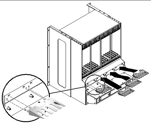

The purple cable management brackets for the chassis are located in the Netra CT server shipping kit. The cable management brackets bundle the various cables connected to the rear of the chassis. The Netra CT chassis comes with four cable management brackets.
1. Align the notches on the sides of the bracket to the chassis holes.
FIGURE 6-1 shows where the brackets are installed at the rear of the chassis.
2. Push the bracket straight into the chassis holes until it engages with the chassis.
If necessary, push down slightly on the top notchesuntil they engage with the holes in the chassis. See FIGURE 6-1.
3. Repeat Step 1 and Step 2 until all four cable management brackets are installed.

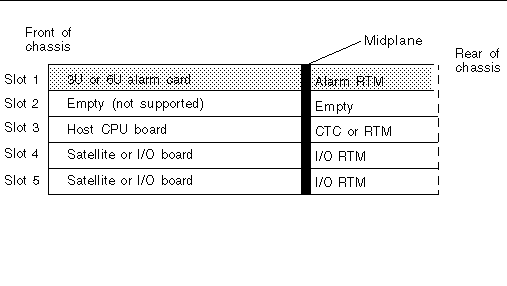

1. Go to the rear of the chassis and locate the RTM corresponding to the host board.
FIGURE 6-2 shows the location of RTMs in a Netra CT 810 server, and FIGURE 6-3 shows the location of RTMs in a Netra CT 410 server.

1. Go to the rear of the chassis and locate the alarm RTM.
FIGURE 6-7 shows the slot available for the alarm RTM in a Netra CT 810 server, and FIGURE 6-8 shows the slot available for the alarm RTM in a Netra CT 410 server.

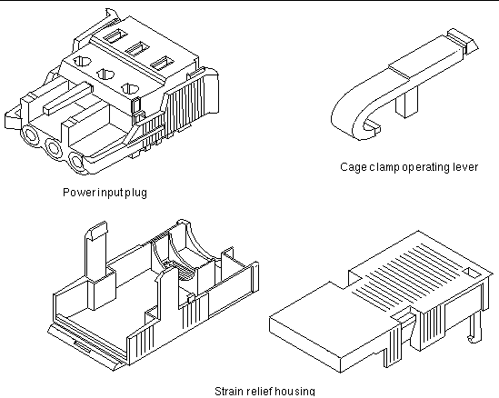

1. Identify the parts that you need to assemble the input power cable (FIGURE 6-13).
The following connection parts are provided in this kit so that you can assemble one or more power input cables. These cables connect the -48V DC input source to the power supply units in your:

6. Open the cage clamp in one of the following ways:
a. Open the cage clamp by inserting the tip of the cage clamp operating lever into the rectangular hole directly above the hole in the input plug where you want to insert the first wire, then press down on the cage clamp operating lever.
b. Open the cage clamp by inserting a small slotted screwdriver into the rectangular hole directly above the hole in the input plug where you want to insert the first wire, then by press down on the screwdriver.

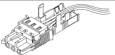

7. Feed the exposed section of the appropriate wire into that hole in the input plug.
FIGURE 6-17 shows which wires should be inserted into each hole in the input plug.
8. Repeat Step a and Step 7 for the other two wires to complete the assembly of the input power cable.
9. Repeat Step 4 through Step 8 to create as many input power cables as you need for your unit.
You need one input power cable for every power supply that you have in a Netra CT server chassis.
If you need to remove a wire from the input plug, insert the cage clamp operating lever or a small screwdriver into the slot directly above the wire, then press down (FIGURE 6-15 and FIGURE 6-16), and pull the wire from the input plug.

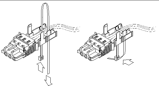

1. Take the input plug and insert the bottom portion of the strain relief housing into the notch on the input plug until it snaps into place.
Make sure the strain relief housing snaps into place on the input plug; you cannot complete the assembly correctly until the strain relief housing is snapped into place.
2. Route the three wires coming from the power source through the opening at the end of the bottom portion of the strain relief housing.
3. Get the tie wrap and insert it into the bottom portion of the strain relief housing.
4. Loop the tie wrap over the wires and back out of the strain relief housing, then tighten the tie wrap to secure the wires to the strain relief housing (FIGURE 6-20).
5. Lower the top portion of the strain relief housing so that the three prongs on the top portion insert into the openings in the input plug, then push the top and bottom portions of the strain relief housing together until they snap into place.
