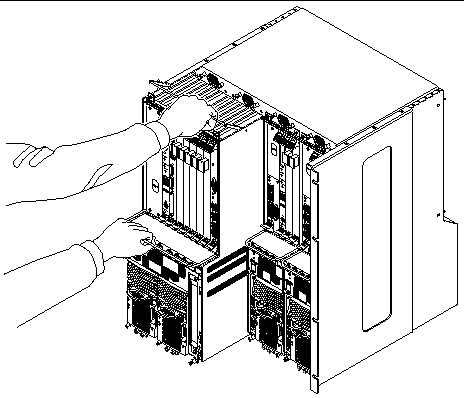

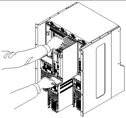

1. With your left hand, grasp the server bar in front.
2. With your right hand, grasp the purple server handle at the top of the server and insert the server into the chassis.
FIGURE 4-2 shows how to insert a Netra CT 810 server into the chassis and FIGURE 4-3 shows how to insert a Netra CT 410 server into the chassis.
3. Push the purple server handle at the top of the server down and gently push the server the remaining distance into the chassis.

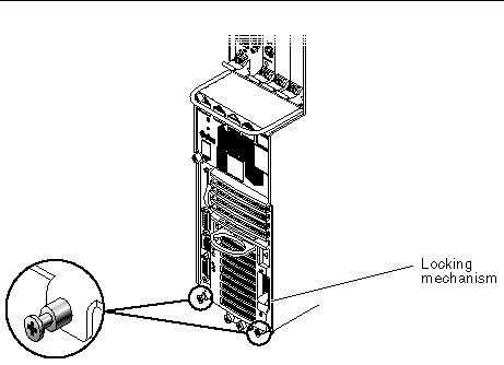

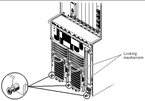

4. Using a No. 2 Phillips screwdriver, tighten the black captive screws at the top of the server.
Tighten the screws on the server to a torque of 0.45 - 0.68 N.m (4 - 6 in.-lb.).
5. Using a No. 2 Phillips screwdriver, tighten the black captive screws at the bottom of the server.
6. Push the power supply unit locking mechanism(s) down into the locked (
) position.
FIGURE 4-6 shows the location of the two power supply unit locking mechanisms on the Netra CT 810 server, and FIGURE 4-7 shows the location of the single power supply unit locking mechanism on the Netra CT 410 server. Make sure you lock both power supply units if you are replacing a Netra CT 810 server.
