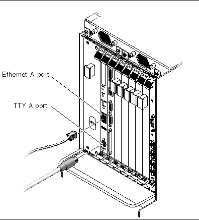

FIGURE A-1 shows the locations of the connectors on the CPU card.
FIGURE A-1 Connectors on the CPU Card
A.1.1 Ethernet A Port
The twisted pair Ethernet connector is an R-J45 connector. The controller auto-negotiates to either 10BASE-T or 100 BASE-T.
FIGURE A-2 RJ-45 Ethernet Connector Diagram

A.1.2 TTY A Port
This port is connected logically to serial port A. It is intended to be used only for serial output to a terminal.
Caution - Serial port A is also connected through the rear cPCI connectors. No mechanism is provided to disable simultaneous input from the front panel and the rear cPCI connectors. Attempts to input data from both ports will place the board in an unknown state.
FIGURE A-3 TTY A Connector

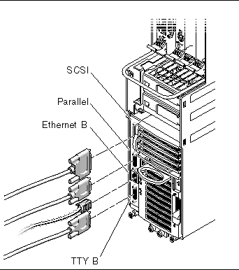

A.2 CPU Front Transition Card, Netra CT 410 Server
FIGURE A-4 shows the locations of the connectors on the CPU front transition card (CPU FTC) for the Netra CT 410 server.
FIGURE A-4 Connectors on the CPU Front Transition Card (Netra CT 410 Server)
A.2.1 SCSI (VHDC)
The SCSI port on the CPU FTC for the Netra CT 410 server is a 68-pin CHAMP very high-density connector (VHDC). A VHDC-to-SCSI 3 cable is available through Sun, if necessary (part number 530-2453-xx, X3832A).

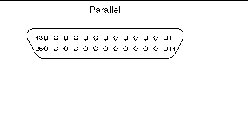

A.2.2 Parallel Port
The parallel port on the CPU FTC for the Netra CT 410 server is an AMPLIMITE SLIMLINE female receptacle.
FIGURE A-5 Parallel Connector
TABLE A-4 Parallel Port Pinouts, CPU FTC for the Netra CT 410 Server

A.2.3 Ethernet B Port
The Ethernet B port on the CPU FTC for the Netra CT 410 server is an RJ-45 connector for 10/100.

A.2.4 TTY B
The TTY B port on the CPU FTC for the Netra CT 410 server is a DB-9 male connector.
FIGURE A-7 TTY B Connector

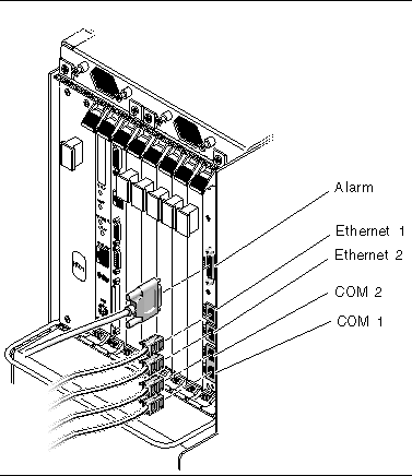

A.4 Alarm Card, 6U Single-Wide
FIGURE A-10 shows the locations of the connectors on the 6U single-wide alarm card. Note that the figure shows the 6U single-wide alarm card installed in a Netra CT 810 server; the 6U single-wide alarm card will be installed in a different slot in a Netra CT 410 server, but the ports are exactly the same.
FIGURE A-10 Connector Ports in the 6U Single-Wide Alarm Card
A.4.1 Alarm Port
I/O connections are available through the male DB-15 alarm port.

A.4.2 Ethernet Ports 1 and 2
Ethernet ports 1 and 2 on the alarm cards use standard RJ-45 connectors. Ethernet port 1 is a 10Mbps Ethernet port, and Ethernet port 2 is a 10/100 Mbps Ethernet port.
FIGURE A-12 RJ-45 Ethernet Connector Diagram

A.4.3 COM Ports 1 and 2
COM ports 1 and 2 on the alarm cards use standard RJ-45 connectors.
FIGURE A-13 RJ-45 Ethernet Connector Diagram

FIGURE A-20 COM Ports 1 and 2
TABLE A-18 COM Ports 1 and 2 Connector Pinouts, Alarm Rear Transition Card
Pin No.
Description
1
DCD
2
RXD
3
TXD
4
DTR
5
GND
6
DSR
7
RTS
8
CTS
9
RI
A.6.3 Alarm Port
The alarm port on the alarm rear transition card uses a standard male DB-15 connector.
FIGURE A-21 Alarm Port
TABLE A-19 Alarm Port Pinouts
Pin No.
Signal
Pin No.
Signal
Pin No.
Signal
1
RESET0 +
6
ALARM0_NC
11
ALARM2_NO
2
RESET0 -
7
ALARM0_COM
12
ALARM2_NC
3
RESET1 +
8
ALARM1_NO
13
ALARM2_COM
4
RESET1 -
9
ALARM1_NC
14
ALARM3_NO
5
ALARM0_NO
10
ALARM1_COM
15
ALARM3_COM
