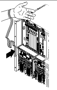

1.2 Attaching the Antistatic Wrist Strap
Most field-replaceable units have sensitive electronic components that require antistatic precautions.
1. Get the antistatic wrist strap and electrostatic discharge mat from the ship kit.
2. Place the electrostatic discharge mat close to the system.
3. Unwrap the first two folds of the wrist strap and wrap the adhesive side firmly against your wrist.
4. Peel the liner from the copper foil at the opposite end of the wrist strap and attach the copper end of the strap to a bare metal area on the Netra CT server or on the chassis.
FIGURE 1-1 Attaching the Antistatic Wrist Strap

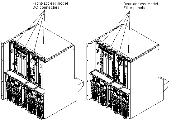

1.3 Determining If You Have a Front-Access or Rear-Access Model
If you are not sure whether you have a front-access or a rear-access model, go to the front of the chassis and look at the top part of the chassis.
- If you see the DC connectors at the front of the chassis, then you have a front-access model (FIGURE 1-2).
- If you do not see DC connectors at the front of the chassis, and metal filler plates fill the gaps where the DC connectors would normally be, then you have a rear-access model (FIGURE 1-2). The DC or AC connectors are at the rear of the chassis for the rear-access model.
FIGURE 1-2 Front-Access and Rear-Access Models

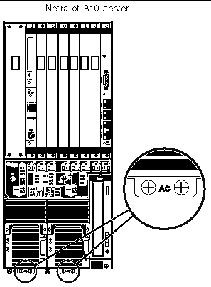

1.4 Determining If You Have AC- or DC-Powered Servers and Chassis
All of the Netra CT servers installed in a chassis must be either AC or DC; do not mix AC- and DC-powered servers in the same chassis. Even though there are no differences in most of the components in the AC- and DC-powered servers (such as fans, boards, and drives), the differences in the power supplies and the power connectors restrict you from mixing AC- and DC-powered servers in the same chassis.
The label located between the two silver screws at the base of the each power supply unit tells you whether the servers in the chassis are all AC- or DC-powered (FIGURE 1-3).
FIGURE 1-3 Locating the Power Supply Units in the Netra CT Servers

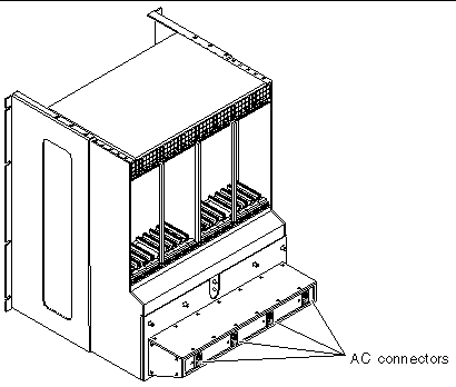

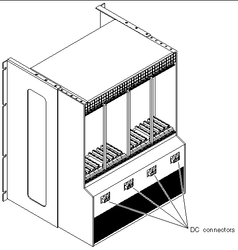

You can also determine if a chassis is powered by AC or DC by looking at the connectors at the rear of the chassis. FIGURE 1-4 shows the connectors at the rear of an AC-powered chassis and FIGURE 1-5 shows the connectors at the rear of a DC-powered chassis.
FIGURE 1-4 AC Connectors on a Netra CT Chassis
FIGURE 1-5 DC Connectors on a Netra CT Chassis
