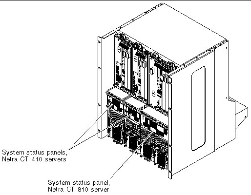

4.1.1 Locating and Understanding the System Status Panel
The system status panel on the Netra CT server give the majority of troubleshooting information that you will need for your server. FIGURE 4-1 shows the locations of the system status panels on the Netra CT servers. FIGURE 4-2 shows the system status panel for the Netra CT 810 server, and FIGURE 4-3 shows the system status panel for the Netra CT 410 server.
FIGURE 4-1 System Status Panel Locations
FIGURE 4-2 System Status Panel (Netra CT 810 Server)
FIGURE 4-3 System Status Panel (Netra CT 410 Server)

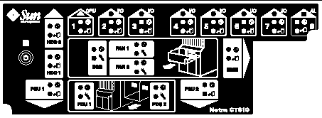

4.1.2 Using the System Status Panel LEDs to Troubleshoot the System
When you first power-on the Netra CT server, some or all of the green Power LEDs on the system status panel flash on and off for several seconds. Do not attempt to troubleshoot the system until after the LEDs have gone through their initial power-on testing.
Each major component in the Netra CT 810 server or Netra CT 410 server has a set of LEDs on the system status panel that gives the status on that particular component. Each component will have either the green Power and the amber Okay to Remove LEDs (FIGURE 4-4) or the green Power and amber Fault LEDs (FIGURE 4-5).
FIGURE 4-4 Power and Okay to Remove LEDs
FIGURE 4-5 Power and Fault LEDs
TABLE 4-1 describes which combination of LEDs is used for each component in the Netra CT 810 server, and TABLE 4-2 describes which combination of LEDs is used for each component in the Netra CT 410 server. Note that the components in the Netra CT servers all have the green Power LED, and they will have either the amber Okay to Remove LED or the amber Fault LED, but not both.
TABLE 4-1 System Status Panel LEDs for the Netra CT 810 Server

TABLE 4-2 System Status Panel LEDs for the Netra CT 410 Server

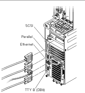

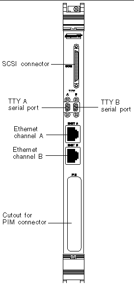

2. Make sure all the necessary cables are attached properly to the CPU transition card.
The following figures show the connectors on the different CPU transition cards:
Note - The CPU rear transition card is the same for both the Netra CT 810 server and the Netra CT 410 server; only the location in the rear card cage differs.
FIGURE 4-6 Connectors on the CPU Front Transition Card (Netra CT 410 Server)
FIGURE 4-7 Connectors on the CPU Rear Transition Card
