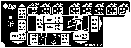

LED Information
The system status panel is a module designed to give feedback on the status of the key components within the Netra CT server. The system status panel has one set of LEDs for each component within that particular server. FIGURE 3-1 shows the LEDs on the system status panel for the Netra CT 810 server, and FIGURE 3-2 shows the LEDs on the system status panel for the Netra CT 410 server.
  FIGURE 3-1 System Status Panel (Netra CT 810 Server)
Picture showing LEDs on the Netra CT 810 server system status panel.
TABLE 3-5 describes the system status panel LEDs for the Netra CT 810 server.
TABLE 3-5 System Status Panel LEDs for the Netra CT 810 Server
LED
LEDs Available
Component
HDD 0
Power and Okay to Remove
Upper hard disk drive
HDD 1
Lower hard disk drive
Slot 1
Host CPU board installed in slot 1
Slots 2-7
I/O boards or satellite CPU boards installed in slots 2-7
Slot 8
Alarm card installed in slot 8
SCB
Power and Fault
System controller board (behind the system status panel)
FAN 1
Power and Fault
Upper fan tray (behind the system status panel)
FAN 2
Power and Fault
Lower fan tray (behind the system status panel)
RMM
Removable media module
PDU 1
Power and Fault (DC only)
Left power distribution unit (behind the server)
PDU 2
Right power distribution unit (behind the server)
PSU 1
Left power supply unit
PSU 2
Right power supply unit
