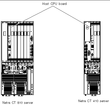

Every Netra CT server contains one host CPU board. The Netra CT 810 servers and the Netra CT 410 servers use the same host CPU board. A specific slot is reserved for the host CPU board in both the Netra CT 810 server (slot 1) and the Netra CT 410 server (slot 3), indicated by a red board cage guide. FIGURE 4-1 shows where the host CPU board must be installed in both server models.
FIGURE 4-1 Host CPU Board Required Locations
Figure showing the location of the host CPU board in the Netra CT 810 server (slot 1) and the Netra CT 410 server (slot 3).

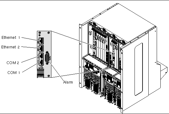

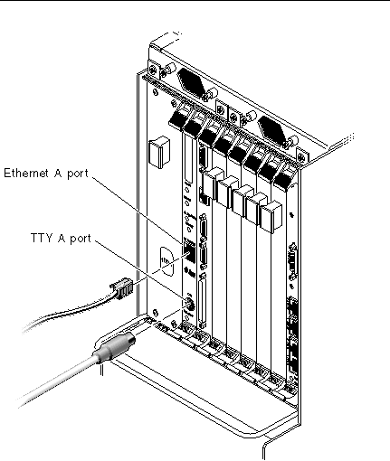

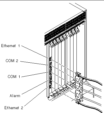

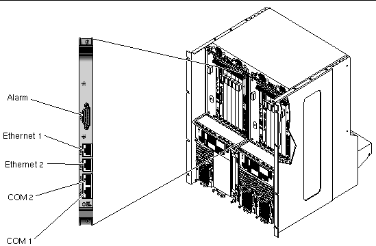

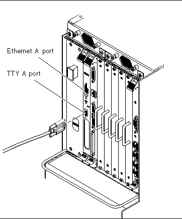

FIGURE 4-2 shows the ports on a Netra CP2140 host CPU board. FIGURE 4-3 shows the ports on a Netra CP2500 host CPU board. Do not use the TTY A port on a host CPU board for the Netra CT 810 server or Netra CT 410 server because the rear transition modules for those models all have a TTY A port.
FIGURE 4-2 Netra CP2140 Host CPU Board
Figure showing the location of the ports on the Netra CP2140 host CPU board. From top-to-bottom: the Ethernet A port and the TTY A port.
FIGURE 4-3 Netra CP2500 Host CPU Board
Figure showing the location of the ports on the Netra CP2500 host CPU board. From top-to-bottom: the Ethernet A port and the TTY A port.

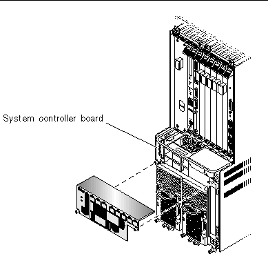

System Controller Boards
The system controller board is a hot-swappable component located behind the system status panel; you must remove the system status panel to access the system controller board. The system controller board feeds system status information to the system status panel, where LEDs give feedback on the status of the key components within the Netra CT servers.
The location of the system controller board in a Netra CT 810 server is illustrated in FIGURE 4-4, and the location of the system controller board in a Netra CT 410 server is illustrated in FIGURE 4-5.
FIGURE 4-4 System Controller Board Location on Netra CT 810 Server
Figure showing the location of the system controller board behind the system status panel in the Netra CT 810 server.

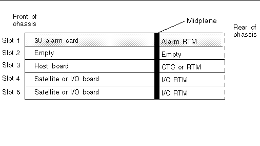

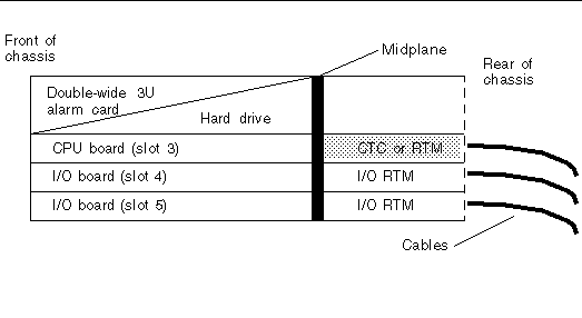

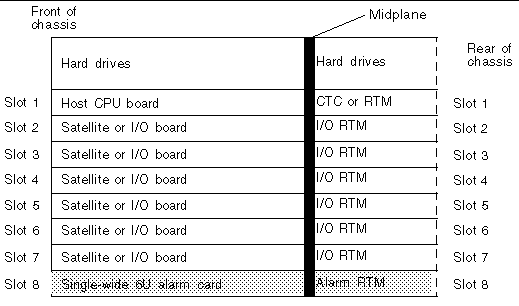

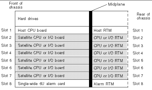

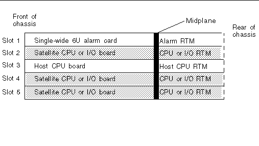

FIGURE 4-8 and FIGURE 4-9 are graphical representations of how satellite CPU boards align with the satellite RTMs. Note that, if you are facing the front of the server, the I/O slots read from left to right, whereas they read from right to left if you are facing the rear of the server.
FIGURE 4-8 Supported Locations for Satellite CPU or I/O Rear Transition Module Sets in a Netra CT 810 Server (Top View)
Figure showing the locations of the satellite CPU or I/O rear transition modules in the Netra CT 810 server (slots 2 through 7 in the rear).
FIGURE 4-9 Supported Locations for Satellite CPU or I/O Rear Transition Module Sets in a Netra CT 410 Server (Top View)
Figure showing the locations of the satellite CPU or I/O rear transition modules in the Netra CT 810 server (slots 2, 4 and 5 in the rear).

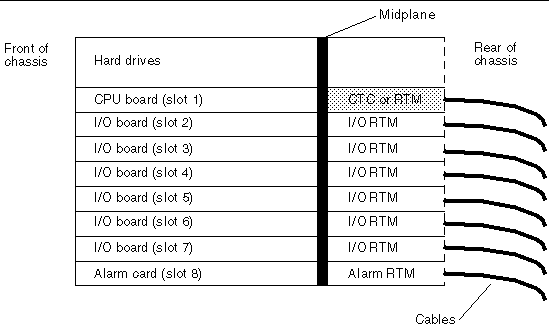

I/O Board and Rear Transition Module Sets
An I/O board and rear transition module set consists of two separate boards:
The I/O board contains the application-specific integrated cicuits (ASICs) for the associated I/O board and is installed from the front of the server; however, no cables are connected to the I/O board.
The I/O RTM extends the ports for a particular I/O board to the rear of the server. The I/O RTM and the I/O board must be installed in the same slot number for the I/O RTM to work. For example, if you install an I/O RTM in I/O slot 3 at the rear of a Netra CT 810 server, you must install the accompanying I/O board in I/O slot 3 at the front of the server.
If one of the two boards fails, replace both the I/O board and the I/O RTM. FIGURE 4-8 and FIGURE 4-9 show graphical representations of how the I/O boards align with the I/O RTMs. Note that, if you are facing the front of the server, the I/O slots read from left to right, whereas they read from right to left if you are facing the rear of the server.

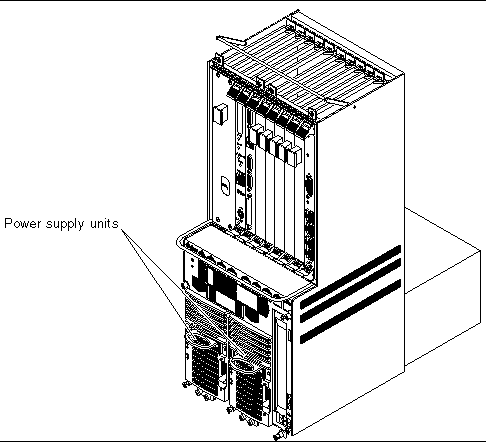

Power Supply Units
Every Netra CT 810 server contains two power supply units, and every Netra CT 410 server contains one power supply unit. The Netra CT 810 servers and Netra CT 410 servers use the same power supply units.
For the Netra CT 810 server, one power supply unit is redundant. Feeds are supplied to each of the power supply units through the power distribution units (see Chapter 2 for information). Because each Netra CT 810 server has two power supply units, the server receives power from two power sources. If one power source or one power supply unit fails, the server continues normal operation using the remaining power supply. Note that this is not the case for the Netra CT 410 server, because it has only one power supply unit.

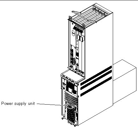

The locations of the power supply units in the Netra CT 810 server are illustrated in FIGURE 4-10, and the location of the power supply unit in the Netra CT 410 server is illustrated in FIGURE 4-11.
FIGURE 4-10 Power Supply Unit Locations on Netra CT 810 Server
Figure showing the location of the power supply units in the Netra CT 810 server.
FIGURE 4-11 Power Supply Unit Location on Netra CT 410 Server
Figure showing the location of the power supply unit in the Netra CT 410 server.

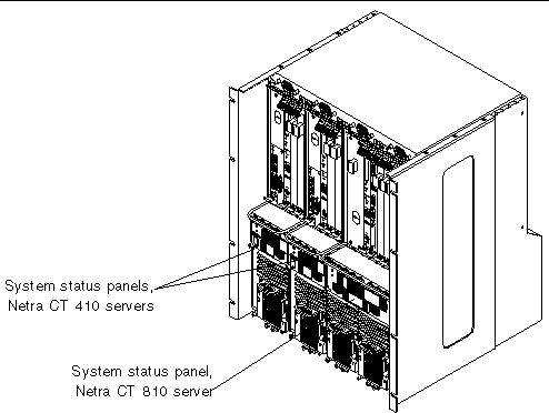

System Status Panels
System status panels give feedback on the status of key components within Netra CT servers. The locations of system status panels in Netra CT 810 servers and Netra CT 410 servers are illustrated in FIGURE 4-12.
FIGURE 4-12 System Status Panel Locations
Figure showing the locations of the system status panels on the Netra CT 810 server and Netra CT 410 server.

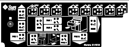

The system status panel has one set of LEDs for each component within that server. FIGURE 4-13 shows the LEDs on the system status panel for the Netra CT 810 server, and FIGURE 4-14 shows the LEDs on the system status panel for the Netra CT 410 server.
FIGURE 4-13 System Status Panel (Netra CT 810 Server)
Figure showing the system status panel for the Netra CT 810 server.
TABLE 4-2 System Status Panel LEDs for the Netra CT 810 Server

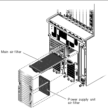

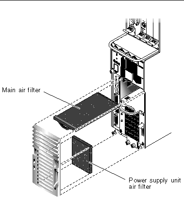

Both the Netra CT 810 servers and the Netra CT 410 servers have two types of air filters: a power supply unit air filter, which filters the air going into the power supply, and a main air filter, which filters the air going into the server. Both air filters are located in the power supply unit.
The power supply unit air filter is located at the front of the power supply unit and the main air filter is located in a tray at the top of the power supply unit. Both sets of air filters should be replaced every three to six months. If your server environment is especially dirty, you might have to replace them more frequently. The power supply unit air filter must be in place for safe operation. FIGURE 4-17 shows the locations of the air filters in a Netra CT 810 server power supply unit, and FIGURE 4-18 shows the locations of the air filters in a Netra CT 410 server power supply unit.
caution icon
Caution - There is an energy hazard present if the power supply unit air filter is not installed. If you remove the power supply unit air filter, you must replace the filter immediately and replace the outer cover for the safe operation of your system. Refer to the instructions in the Netra CT Server Service Manualfor more information.
FIGURE 4-17 Power Supply Unit Air Filter and Main Air Filter (Netra CT 810 Server)
Figure showing the locations of the power supply unit air filter and the main air filter in the Netra CT 810 server.
FIGURE 4-18 Power Supply Unit Air Filter and Main Air Filter (Netra CT 410 Server)
Figure showing the locations of the power supply unit air filter and the main air filter in the Netra CT 410 server.

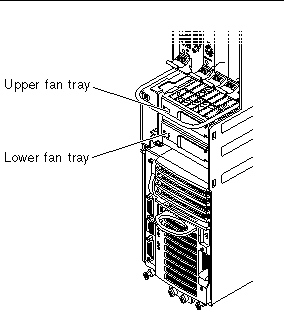

Fan Trays and Fans

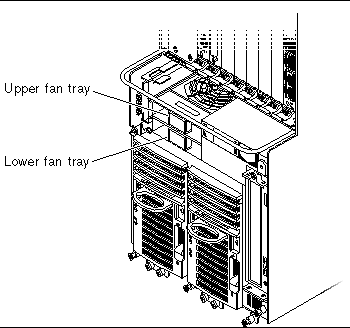

Both the Netra CT 810 servers and the Netra CT 410 servers have two fan trays. The fan tray for the Netra CT 810 server has a single large fan in each tray, while the fan tray for the Netra CT 410 server has two smaller fans in each tray. The fan tray is designed to be hot-swappable. High-speed fans are required to support Netra CP2500 boards.
If the temperature rises above 158°F (70°C), the CPU board sends out a warning that the system is overheating. If the temperature rises above 167°F (75°C), the system shuts down automatically. Note that the temperatures here are not ambient air temperatures, but rather the CPU temperatures that are monitored by a thermistor located under the heatsink on the host CPU board.
If one fan tray fails, you must replace the failed fan tray as soon as possible. Even though the system can run on one fan tray, if the temperature rises, a single fan tray might not be able to cool the system properly.
The fans are located underneath the board cage behind the system status panel (see System Status Panels for the location of the system status panel). They are recessed into the operations board cage to maximize the air flow across the CompactPCI boards. FIGURE 4-19 shows the locations of the fan trays in a Netra CT 810 server, and FIGURE 4-20 shows the locations of the fan trays in a Netra CT 410 server. Note that the system status panel is removed in both figures.
FIGURE 4-19 Fan Trays (Netra CT 810 Server)
Figure showing the location of the fan trays behind the system status panel in the Netra CT 810 server.
FIGURE 4-20 Fan Trays (Netra CT 410 Server)
Figure showing the location of the fan trays behind the system status panel in the Netra CT 410 server.

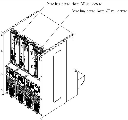

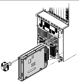

Hard Drives
Hard drives are fully hot-swappable. Each hard drive has its own latching mechanism to ensure a positive lock with the chassis. You can have a maximum of two hard drives in the Netra CT 810 server and one hard drive in the Netra CT 410 server. The Netra CT 810 servers and the Netra CT 410 servers both use the same hard drives.
A specific slot is reserved for hard drives in both Netra CT 810 servers and Netra CT 410 servers. The hard drives are behind the drive bay cover.
Following are the SCSI IDs for the hard drives:
In addition, two separate SCSI chains are in the Netra CT 810 server for the SCSI devices:
FIGURE 4-21 Drive Bay Cover Locations
Figure showing the locations of the disk drive bay covers on the Netra CT 810 server and Netra CT 410 server.

FIGURE 4-23 Single-Wide 6U Alarm Card (Netra CT 810 Server)
Figure showing the ports on the single-wide 6U alarm card. From top-to-bottom: the alarm port, Ethernet 1, Ethernet 2, COM 2, then COM 1.

Alarm Rear Transition Modules
An alarm rear transition module (RTM) is paired with the alarm card in both the Netra CT 810 server and the Netra CT 410 server. Either the single-wide 6U alarm card or the double-wide 3U alarm card can be used with the alarm rear transition module. The alarm rear transition module must be installed in the same slot number, at the rear of the server, as the alarm card.
The alarm rear transition module extends the ports on the alarm card installed at the front of the server to the alarm rear transition module installed at the rear of the server. Ethernet port 1 is a 10-Mbps Ethernet port, and Ethernet port 2 is a 10/100 Mbps Ethernet port. FIGURE 4-25 shows the ports for the alarm rear transition module. FIGURE 4-26 shows the location of the alarm rear transition module in a Netra CT 810 server, and FIGURE 4-27 shows the location of the alarm rear transition module in a Netra CT 410 server.
FIGURE 4-25 Alarm Rear Transition Module
Figure showing the ports on the alarm rear transition module. From top-to-bottom: Ethernet 1, COM 2, COM 1, the alarm port, then Ethernet 2.
FIGURE 4-26 Supported Location for the Alarm Rear Transition Module in a Netra CT 810 Server (Top View)
Figure showing the location of the alarm rear transition module in the Netra CT 810 server (slot 8 in the rear).
FIGURE 4-27 Supported Location for the Alarm Rear Transition Module in a Netra CT 410 Server (Top View)
Figure showing the location of the alarm rear transition module in the Netra CT 410 server (slot 1 in the rear).
