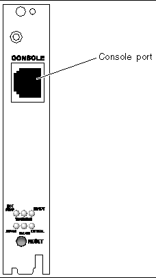

Ports on the Distributed Management Card
FIGURE 4-1 shows the location of the console port on the distributed management card. The pinouts for the console port on the distributed management card are given in Console Port.
FIGURE 4-1 Location of the Console Port on the Distributed Management Card
Console Port
The console port on the distributed management card uses a standard RJ-45 connector.

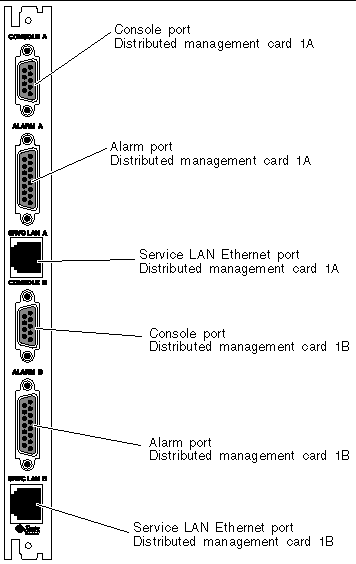

Ports on the Rear Transition Card for the Distributed Management Card
FIGURE 4-3 shows the ports on the rear transition card for the distributed management cards. Note that a single rear transition card gives ports for both of the distributed management cards installed in the front of the server (1A and 1B).
FIGURE 4-3 Distributed Management Card Rear Transition Module Ports
[ D ]
Following are the pinouts for each of the ports on the rear transition module for the distributed management card:

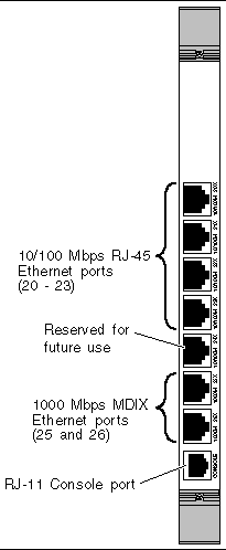

Connecting Cables to the Switching Fabric Boards
Note - If you want the Ethernet signals to be routed to the rear transition card for the switching fabric board, verify that the SW503 DIP switch on the Netra CP2300 board is set correctly. See Ethernet Networking on the Netra CP2300 Board for more information before proceeding with these instructions.
Note - The external Ethernet interface on the distributed management card and the external Ethernet interface on the switching fabric board must be connected to different subnets. If they are configured on the same subnet, arp messages will be displayed on the distributed management card console.
The Netra CT 820 server is available only as a rear-access server, so all of the cabling for the switching fabric board will be to the rear transition card at the rear of the server. There are no active components on the rear transition card, so you must have the accompanying switching fabric board installed in the same slot at the front of the server, even though no cables will be connected to that front card. The rear transition card is connected to the switching fabric board through the midplane through the RJ3 and RJ5 CompactPCI connectors. This card used to route Ethernet traffic through five 10/100-megabit switched Ethernet MDIX ports through shielded RJ-45 connectors (ports 20-23), two 1000-megabit Ethernet MDIX ports (ports 25-26), and an RJ-11 console port. FIGURE 4-7 shows the ports on the rear transition card for the switching fabric board.
Note - Port 24 on the rear transition card for the switching fabric board is reserved for future use.
FIGURE 4-7 Ports on the Rear Transition Card for the Switching Fabric Board

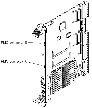

PMCs on the Netra CP2300 Board
FIGURE 4-11 shows the location of the PMCs on the Netra CP2300 board, and PMC Connectors gives connector interface information for the PMC slots.
FIGURE 4-11 Netra CP2300 Board

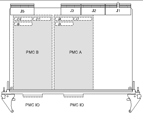

PMC Connectors
FIGURE 4-12 shows the locations of PMC port connectors. The following tables show contact allocations.
FIGURE 4-12 Netra CP2300 Board PMC Port Connectors
Note - The P1386.1 standard reserves the Jn3 64-pin connector for PCI 64-bit extensions, so it is not fitted on the Netra CP2300 board.
PMC B Connector Interfaces
The PMC B connector interface consists of three connectors: J6, J12, and J11. These connectors conform to the common mezzanine card (CMC) specification.

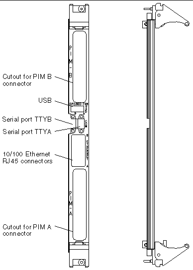

USB Port
FIGURE 4-15 shows the USB connector port A on the rear transition card for the Netra CP2300 board. TABLE 4-19 lists the pin assignments for the USB port.
FIGURE 4-15 USB Connector Port A Pins
TABLE 4-19 USB Port A
Pin
Signal
1
+5V POWER
2
POS
3
NEG
4
GND
Serial Ports
Two serial ports from the Netra CP2300 transition card are available through the rear panel with single-stacked, 9-pin connectors. One connector is assigned to Port A and the other connector to Port B (FIGURE 4-16).
FIGURE 4-16 Serial Port Connector Pins
The signal interfaces of the connectors are described in TABLE 4-20 and TABLE 4-21.
TABLE 4-20 Serial Port A
Pin No.
Signal
Pin No.
Signal
1
SER_A_DCD
6
SER_A_DSR
2
SER_A_RXD
7
SER_A_RTS
3
SER_A_TXD
8
SER_A_CTS
4
SER_A_DTR
9
SER_A_RI
5
GND_A
TABLE 4-21 Serial Port B
Pin No.
Signal
Pin No.
Signal
1
SER_B_DCD
6
SER_B_DSR
2
SER_B_RXD
7
SER_B_RTS
3
SER_B_TXD
8
SER_B_CTS
4
SER_B_DTR
9
SER_B_RI
5
GND_B
