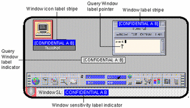

The following figure shows how labels display in an environment configured to display sensitivity labels. It also shows the pointer and indicator when you select Query Window. (Sensitivity labels appear inside square brackets ([]) .)
Figure 4-2 Window Labels in the Trusted Solaris Environment
Graphic

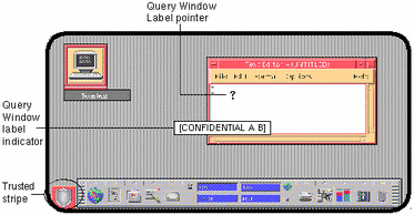

A site can also be configured to hide sensitivity labels, as shown in the following figure.
Figure 4-3 Trusted Stripe with Sensitivity Labels Suppressed
Graphic

Window SL Field
The Window SL field displays the sensitivity label of the active window (that is the window that has the pointer focus). If you are working at one sensitivity label at a time, this may be stating the obvious. However, in a multilevel session, it is possible to have windows with different sensitivity labels in the same workspace. For an example, see "Tour: Occupying Workspaces with Applications at Different Sensitivity Labels".

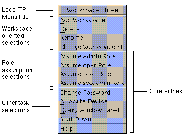

Trusted Path Menu
The Trusted Path (TP) menu can be accessed by holding down the right mouse button in the switch area of the Front Panel. The Trusted Path menu is displayed with a different set of selections and title depending on the location of the pointer as follows:
Note -
The core entries will vary according to your account setup. You may have different roles or none at all. If sensitivity labels are hidden, there will be no Change Workspace SL option. You may not be allowed to allocate devices.
Figure 4-7 The Workspace Version of the Trusted Path Menu
Graphic
The Trusted Menu selections fall into three major categories:
The workspace selections are only displayed when the pointer is over a workspace button; the role assumption and other task selections appear in all TP menus. Note also that your system may have different selections available due to configuration differences.

Query Window Label
Query Window Label changes the pointer to a question mark. As you move the pointer around the screen, the sensitivity label for the region under the pointer is displayed in a small rectangular box at the center of the screen (see below). When you click the mouse button, you return to normal mode. This operation is mainly useful if your system is not configured to display labels in the window frames.
Figure 4-18 Query Window Label Operation
Graphic
