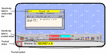

Trusted Solaris uses a string called a sensitivity label (SL) (containing a classification and compartments in similar fashion to clearances) to determine which information you can access. Sensitivity labels may be displayed inside square brackets ([]) in window title bars, in the trusted stripe (a special area at the bottom of the screen), or not at all, depending on how your system is configured. Figure 1-3 shows a configuration configured to display sensitivity labels; the sensitivity labels and trusted stripe are indicated.
Figure 1-3 Typical Environment with Sensitivity Labels Displayed
