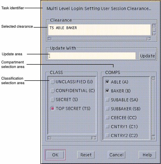

To Select a Clearance for a Multilevel Session
The session clearance sets the top boundary for sensitivity labels of files that you will be able to access in the session. To set the clearance, you use the Clearance Builder dialog box (see Figure 2-5).
  1. To use the default clearance in the Clearance field, click OK (or press Enter) and wait for the Trusted Solaris environment to be displayed.
    For a different clearance, go to step 2 to build a new clearance.
  2. Click the desired classification in the classification selection area.
  3. Click the desired compartments (if any) in the compartments selection area.
  4. Check the clearance you have built in the selected clearance field. Click OK or press Enter if it is correct or go back to step 2 to build a different clearance.
    Figure 2-5 Session Clearance Builder Dialog Box

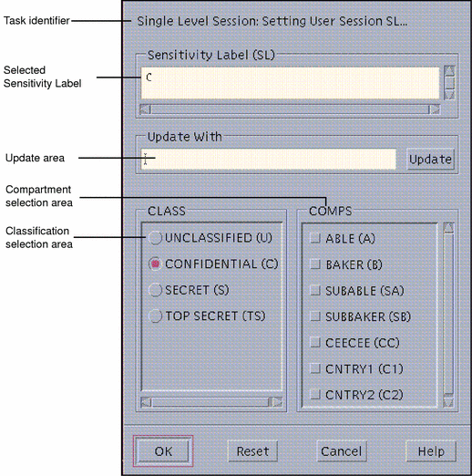

To Select a Sensitivity Label for a Single-level Session
The session sensitivity label sets the sensitivity label at which you intend to operate in this single-level session. To set the session sensitivity label, you use the Single-Level Session Sensitivity Label Builder dialog box shown in Figure 2-6.
  1. To use the default sensitivity label in the Sensitivity Label field, click OK (or press Enter) and wait for the Trusted Solaris environment to be displayed.
    For a different sensitivity label, go to step 2 to build a new sensitivity label.
  4. Check the sensitivity label you have built in the selected sensitivity label field. Click OK or press Enter if it is correct or go back to step 2 to build a different sensitivity label.
    Figure 2-6 Single-Level Session Sensitivity Label Builder
