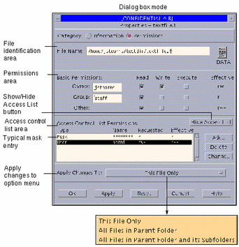

To View or Change a File or Folder's Basic Permissions
  1. Display the File Manager Properties dialog box.
    See "To Display the Properties Dialog Box for a File or Folder".
  2. Click the Permissions button in the Category field.
    This step sets the dialog box to permissions mode (see below).
    Figure 5-6 File Manager: Displaying ACL Entries
    Graphic
  3. Examine the settings in the permissions area.
    The owner, group, and other's read, write, and execute permissions are displayed here, along with buttons for making changes. The Effective column (at the right side of the permissions area) displays the permissions after the ACL mask has been applied as the permissions appear in the command line interface.
  4. To make changes, click the appropriate read, write, or execute buttons for owner, group, or other.
    You can check the result in the Effective column at the right of the area.
  5. To specify the target item(s) for these changes, select the appropriate target in the Apply Changes To option menu at the bottom of the window.
    You can select the current file, all files in the parent folder, or all files in the parent folder and its subfolders.
  6. Click OK or Apply to save the permissions.
To View a File or Folder's ACL Entries
    This sets the dialog box to permissions mode (see Figure 5-6).
  3. Click the Show Access Control List button if the access control list area is not currently displayed.
  4. Examine the entries in the access control list area.
    Any existing ACL entries for the item are displayed in the scroll list, including the type of entry, specified name, requested permissions, and effective permissions. The requested permissions are the default permissions before the ACL mask has been applied--the effective permissions reflect the permissions after the mask has been applied.

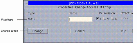

To Change an ACL Entry
  1. Display the File Manager Properties dialog box as described in "To View a File or Folder's ACL Entries".
  2. Select an entry in the access control list area to be changed.

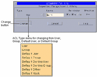

  3. Click the Change button at the right of the ACL area (see figure below) to display the Change Access List Entry dialog box.
    If you have selected an entry of type User, Group, Default User, or Default Group, the dialog box displays a Type menu as in Figure 5-8) and you can change the type. If you select Mask, Default Owning User, Default Owning Group, Default Other, or Default Mask, there is no ACL type menu button and the type is fixed. See Figure 5-9, which is an example of changing a Default Mask entry.
    Figure 5-8 File Manager Change Access List Entry Dialog Box for User, Group, Default User, or Default Group
    Graphic
    Figure 5-9 File Manager Change Access List Entry Dialog Box for Default Mask
    Graphic
  4. Specify the type of ACL entry.
    The type will be limited as discussed in Step 3.
  5. Specify the name (if enabled) and if you wish to change it.
  6. Click the permissions you wish to enable (or disable).
    A check mark means that the permission is enabled. If you select a permission that will be overridden by the mask, a warning will be displayed in the message display area at the bottom of the dialog box, along with a beep. The effective permissions column will indicate the difference. You are nonetheless allowed to make the entry and it will take effect if the mask is modified later.
  7. Click Change in the dialog box.
    This modifies the entry, causing the modification to be displayed in the Access Control List area. Remember that if you select Mask, your modifications may change the effectiveness of the entries for specified users and groups and for the owner's group.

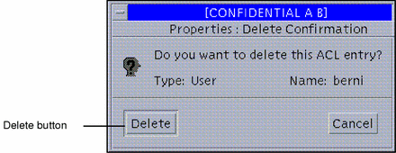

To Delete an ACL Entry
  2. Select the entry to be deleted in the Access Control List area.
  3. Click the Delete button at the right of the ACL area to display the Delete dialog box (see figure below).
    Figure 5-10 File Manager Delete Access List Entry Dialog Box
    Graphic
  4. Confirm that the selected entry is correct and click Delete in the dialog box.
    This removes the entry from the Access Control List area.
